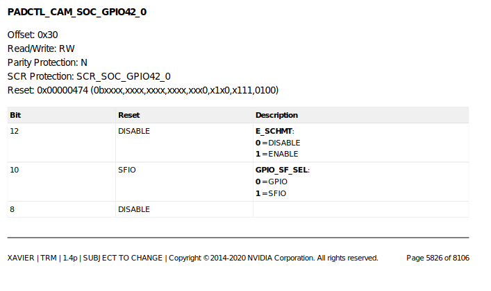

**Author:** ![msd11](https://developer.download.nvidia.com/images/forums/profile-default-devtalk-84.png) [@msd11](https://forums.developer.nvidia.com/u/msd11)\
**Post date:** [August 26, 2021, 11:01am UTC](https://forums.developer.nvidia.com/t/gpio-control-on-xavier-nx-with-register-writes/187050/7 "2021-08-26T11:01:16Z")
</div>
Hey Jerry, thanks for replying
 ![image](https://global.discourse-cdn.com/nvidia/original/3X/2/c/2cffe2080e5ca459e1953b1423aad8ff1ec71b02.png)
 ![image](https://global.discourse-cdn.com/nvidia/original/3X/c/1/c1896e2c3e31ce841e67c985d512cea67e0c5447.png)
I checked out the file you shared. As far as I could understand these registers are configuration registers for the pins, like configuring them as GPIO/SFIO etc. but these registers don’t offer the control over setting the GPIO high/low or setting the GPIO as input or output .
How to locate these registers ? Can it be located using TRM or kernel source ?
