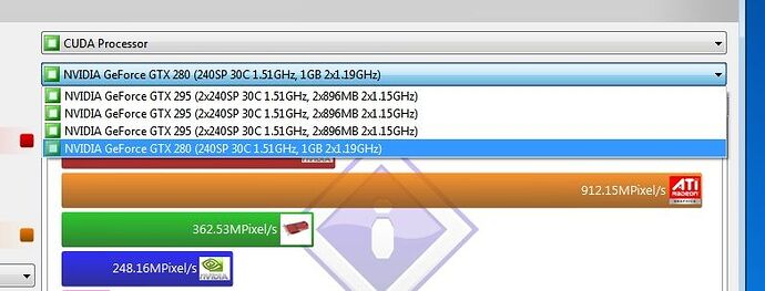

These are my available selections for OpenCL: (The OpenCL test has an extra 295 option in there… 3?)
These are my available selections with CUDA: (The CUDA test has an extra 295 option too.)
These are my available selections with Compute Shader: (The Compute Shader test just has (2) 295’s to select from.)
I see no option for the “combined” card that represents both in any of the tests.
(I might be missing it too?) :)

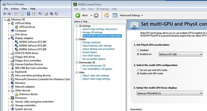

My device manager looks like this, and am running with SLI and PhysX enabled:

I hate to run with SLI disabled, I believe the CUDA test is using it to help my score. I will however try that, to see it my dedicated PhysX processor will no longer receive any processing action, when I have my 295 selected as the GPU to be tested.
Note: That I do have valid display connected to all 3 GPU’s
One side of my 295 is connected to my Gateway main FPD.
The other side of my 295 is connected via HDMI, to a small LG TV. (works fine)
And my 280 is connected to a second input on my display, with an adapter.
The 280 works well to if I activate it in Nvidia Control Panel, and select VGA as input on my display.
I was running set for Single display, Performance mode in the Control Panel.

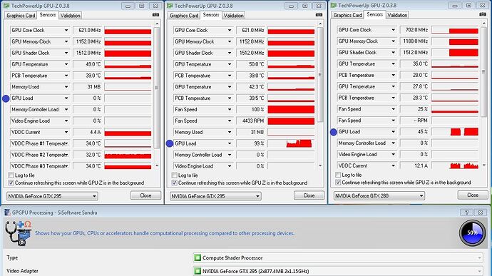

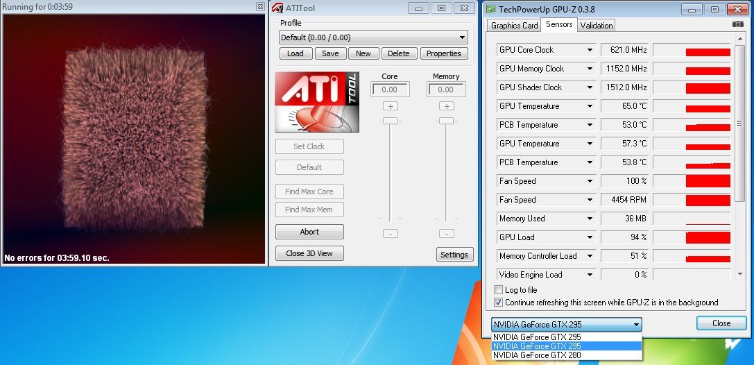

This is the best way to show my load distribution.
I fired up 3 instances of GPU-z, for a better graphical representation of what my 3 GPU’s processing activity was, while each test was running.
NOTE: Every test was run with the default 295 selected, when Sandra initially starts. I only changed the test, not the GPU.
OpenCL Test:
CUDA Test:
[b]
Compute Shader Test:[/b]

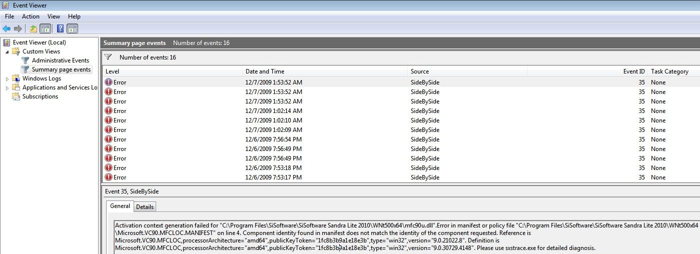

When support looks at this, note that my event viewer doesn’t like Sandra too much!
(I have no idea what that means.) External Media

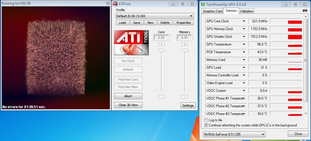

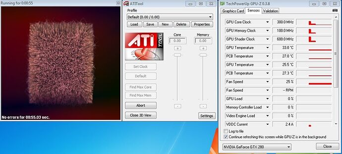

I still find it worth noting, that when I ran ATI Tool with my current config, having both SLI and PhysX enabled…
Processing load was kept to only my 295, and no utilization on my 280 at all.
One 1/2 of my 295 reads 31%.
The other 1/2 of my 295 reads 94%.
And my 280 operating in Dedicated PhysX Mode, reads 0% load, just as it should.
The Final Outcome
Date: 2009-12-07 23:32:08
Name: SiSoftware Technical Support
OK, based on the pictures:
  1. Your 1st card is the 295(both GPUs on it) + 280
  2. Your 2nd card is the 295 - 1 GPU
  3. Your 3rd card is the 295 - 2 GPU
  4. Your 4th card is the 280
Thus if you select (1) you are running on ALL 3 cards, both parts of the 295 + 280.
If you select 2 or 3 you are running 1/2 of the 295.
If you select 4 you are running on the 280.
The issue here is that you have a 295 which through CUDA / OpenCL are ennumerated as indivudual GPUs, thus 2 entries for each GPU on it.
DirectX/Compute Shader uses SLI thus shows 1 card (it combines the 2 GPUs on the 295 as you know).
Sandra knows the 295 is X2, thus it does not say 2x GTX 295 but shows you 2x shaders/memory/etc.
This is purely cosmetic - if you select (1) we run on all cards in parallel, with work distributed depending on their power. I will see what we can do to fix it.
