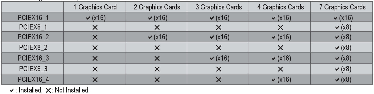

Just confirming the cards are located where recommended?
Thank you for your suggestion.

I appreciate it may not be feasable, but given the task is heavily impacted by the PCIe bandwidth, I wonder if you’ve considered updating CPU/motherboard, as the 3060 is capable of Gen 4 PCIe?
Thanks for the idea, but swapping out my CPU and motherboard just isn’t realistic—unless they completely die, there’s no real reason to do it right now. It’d cost a fortune and might not even fix things, since I still don’t know what’s causing the issue. If it’s the GPU itself, a new board won’t help. It could easily be something simple like a BIOS setting, slot configuration, or even a dodgy cable/retimer, so I’m really hoping it’s one of those.
Looking at the manual, there’s the following note re. multiple cards;
“When two or more graphics cards are installed, we recommend that you connect the power cable
from the power supply to the VGA_PW connector to ensure system stability.”
VGA_PW is a 6 pin GPU power connector next to the left hand bank of RAM sockets.
“Falling off the bus” is commonly caused by power supply instability and the cards alone total 700W, so this area is worth addressing.
Also, make sure you’re monitoring the PCIe link status while the cards are under load, as it is normal for both Gen and Width to be reduced when a card is idle, as a power saving measure.
