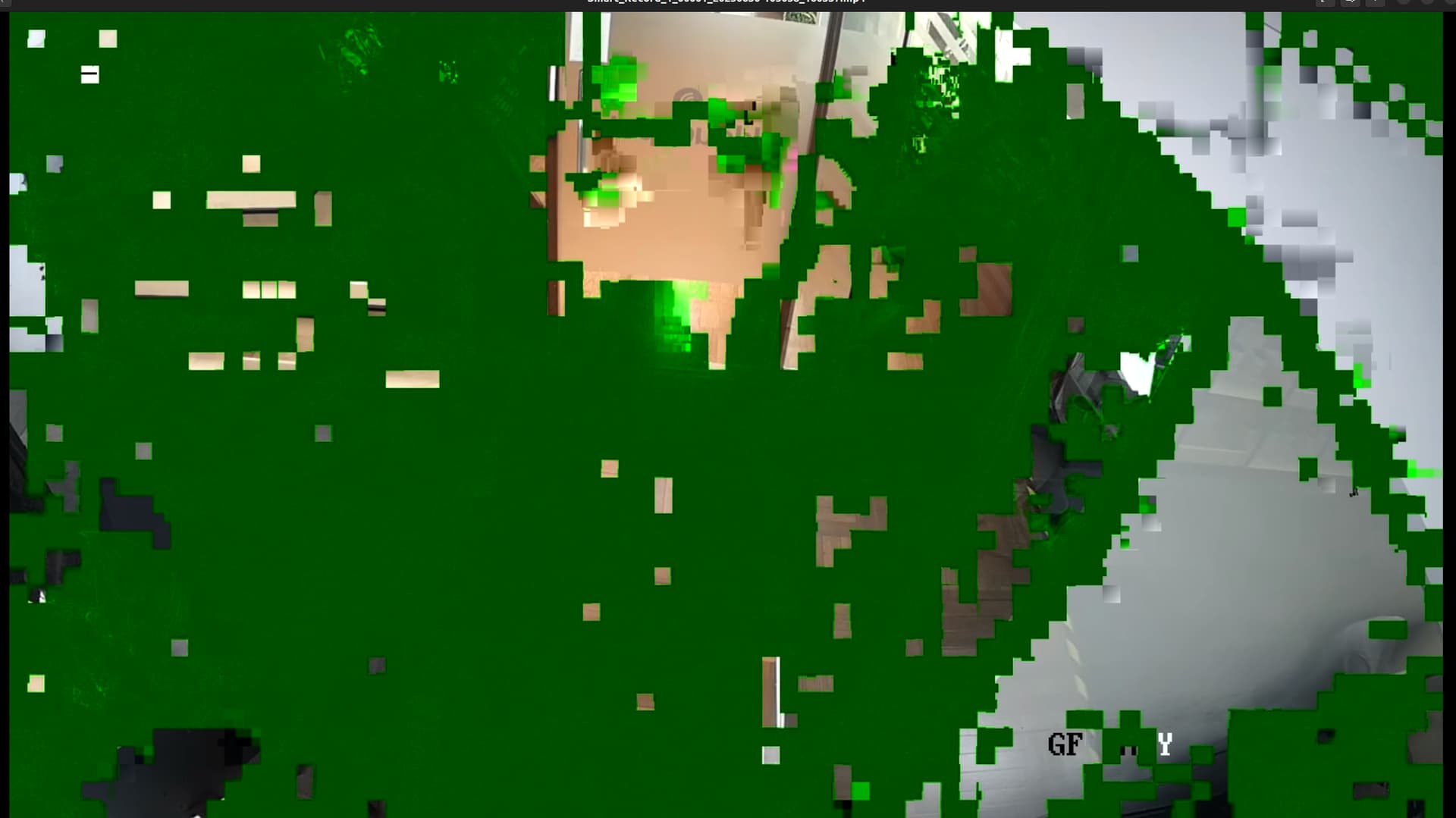

Green blocks in the videos when we transcode from H265 to H264
Continuing the discussion from Issue with smart record If we record through h265 stream:
**• Hardware Platform -----> 4060
**• DeepStream Version ------> 7.1
**• TensorRT Version ---------> 8.6.2.1
**• NVIDIA GPU Driver Version --------> 560.35.05
I tried by implementing transcode functionality in the populate_rtspsrc_bin_video in opt/nvidia/deepstream/deepstream-7.1/sources/gst-plugins/gst-nvurisrcbin/gstdsnvurisrcbin.cpp. Below is my modified code of populate_rtspsrc_bin_video().

once I downloaded and checked my recorded videos which consists of green blocks on the frames. I have attached a frame below. please check the above modified code and please let us know why is it happening and what is the fix for this?

  1. did the “green blocks” issue happen at the begnning or after a while? Here are some steps to narrow down this issue.
    1.1 if linking decoder to nveglglessink or filesink, does this issue still persist? wondering if the raw data is fine. Here are some samples.
gst-launch-1.0  filesrc location=/opt/nvidia/deepstream/deepstream/samples/streams/sample_720p.mp4 ! qtdemux ! h264parse ! nvv4l2decoder ! nveglglessink
gst-launch-1.0 filesrc location=720p.yuv ! videoparse width=1280 height=720 format=i420 framerate=1/1 ! nvvideoconvert ! 'video/x-raw,format=NV12' !  filesink location=3.yuv
1.2 if linking nvv4l2h264enc to filesink, does this issue still persist? wondering if the H264 data is fine. Here is a sample.
gst-launch-1.0  filesrc location=/opt/nvidia/deepstream/deepstream/samples/streams/sample_720p.mp4 ! qtdemux ! h264parse ! nvv4l2decoder  ! nvvideoconvert ! 'video/x-raw(memory:NVMM),format=I420' ! nvv4l2h264enc bitrate=1000000 ! filesink location=test.264
  1. currently, smart recording low-level implementation is closed source.
