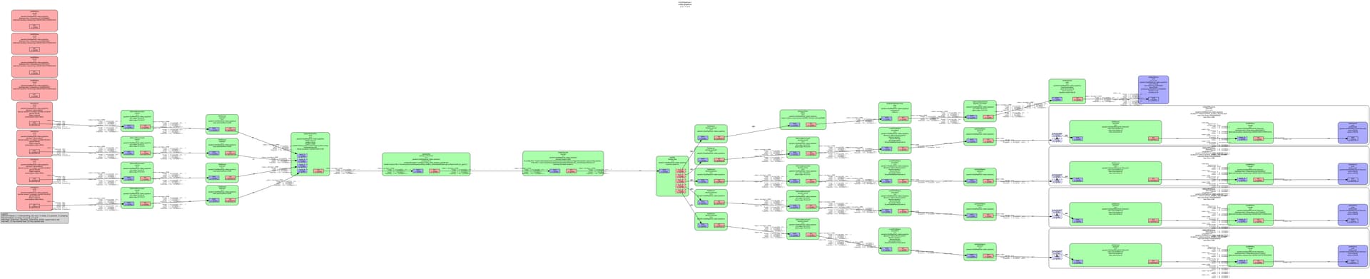

DeepStream 6.2
Gstreamer 1.16.3
I try to link multi camers ,
and single save camera frame to mp4 video,
The Video is Save ,
Also can Display 4 in 1 frame at same time,
But saved single video file have 4 cameras frames,
What am I do wrong on link elements?
Thanks!!!
Dot file:

subgraph cluster_mux0_0x16826020_src {
label="";
style="invis";
mux0_0x16826020_src_0x1680e2e0 [color=black, fillcolor="#ffaaaa", label="src\n[>][bfb]", height="0.2", style="filled,solid"];
fillcolor="#ffaaaa";
subgraph cluster_parser0_0x16815260 {
fontname="Bitstream Vera Sans";
fontsize="8";
style="filled,rounded";
color=black;
label="GstH264Parse\nparser0\n[>]\nparent=(GstPipeline) video-pipeline";
subgraph cluster_parser0_0x16815260_sink {
label="";
style="invis";
parser0_0x16815260_sink_0x167f1d50 [color=black, fillcolor="#aaaaff", label="sink\n[>][bfb]", height="0.2", style="filled,solid"];
subgraph cluster_parser0_0x16815260_src {
label="";
style="invis";
parser0_0x16815260_src_0x1680e090 [color=black, fillcolor="#ffaaaa", label="src\n[>][bfb]", height="0.2", style="filled,solid"];
parser0_0x16815260_sink_0x167f1d50 -> parser0_0x16815260_src_0x1680e090 [style="invis"];
fillcolor="#aaffaa";
parser0_0x16815260_src_0x1680e090 -> filesink0_0x1682e060_video_0x16826d00 [labeldistance="10", labelangle="0", label=" ", taillabel="video/x-h264\l parsed: true\l stream-format: { (string)avc, (stri... }\l alignment: { (string)au, (strin... }\l", headlabel="ANY"]
subgraph cluster_encoder0_0x1680d2a0 {
fontsize="8";
color=black;
label="nvv4l2h264enc\nencoder0\n[>]\nparent=(GstPipeline) video-pipeline\ndevice=\"/dev/nvhost-msenc\"\ndevice-name=\"\"\ndevice-fd=48\nqp-range=NULL\nSliceIntraRefreshInterval=0";
subgraph cluster_encoder0_0x1680d2a0_sink {
label="";
style="invis";
encoder0_0x1680d2a0_sink_0x167f18b0 [color=black, fillcolor="#aaaaff", label="sink\n[>][bfb]", height="0.2", style="filled,solid"];
subgraph cluster_encoder0_0x1680d2a0_src {
label="";
style="invis";
encoder0_0x1680d2a0_src_0x167f1b00 [color=black, fillcolor="#ffaaaa", label="src\n[>][bfb]", height="0.2", style="filled,solid"];
encoder0_0x1680d2a0_sink_0x167f18b0 -> encoder0_0x1680d2a0_src_0x167f1b00 [style="invis"];
encoder0_0x1680d2a0_src_0x167f1b00 -> parser0_0x16815260_sink_0x167f1d50 [labeldistance="10", labelangle="0", label=" ", taillabel="video/x-h264\l stream-format: byte-stream\l alignment: { (string)au, (strin... }\l", headlabel="video/x-h264\l"]
subgraph cluster_record_queue0_0x167f4490 {
fontsize="8";
color=black;
label="GstQueue\nrecord_queue0\n[>]\nparent=(GstPipeline) video-pipeline";
subgraph cluster_record_queue0_0x167f4490_sink {
label="";
style="invis";
record_queue0_0x167f4490_sink_0x167f1410 [color=black, fillcolor="#aaaaff", label="sink\n[>][bfb]", height="0.2", style="filled,solid"];
subgraph cluster_record_queue0_0x167f4490_src {
label="";
style="invis";
record_queue0_0x167f4490_src_0x167f1660 [color=black, fillcolor="#ffaaaa", label="src\n[>][bfb][T]", height="0.2", style="filled,solid"];
record_queue0_0x167f4490_sink_0x167f1410 -> record_queue0_0x167f4490_src_0x167f1660 [style="invis"];
record_queue0_0x167f4490_src_0x167f1660 -> record_conv0_0x167f38d0_sink_0x167f0ad0 [labeldistance="10", labelangle="0", label=" ", taillabel="ANY", headlabel="video/x-raw(memory:NVMM)\l format: { (string)I420, (str... }\l width: [ 1, 2147483647 ]\l height: [ 1, 2147483647 ]\l framerate: [ 0/1, 2147483647/1 ]\lvideo/x-raw\l format: { (string)I420, (str... }\l width: [ 1, 2147483647 ]\l height: [ 1, 2147483647 ]\l framerate: [ 0/1, 2147483647/1 ]\l"]
subgraph cluster_record_conv0_0x167f38d0 {
fontsize="8";
color=black;
label="Gstnvvideoconvert\nrecord_conv0\n[>]\nparent=(GstPipeline) video-pipeline\nsrc-crop=\"0:0:0:0\"\ndest-crop=\"0:0:0:0\"";
subgraph cluster_record_conv0_0x167f38d0_sink {
label="";
style="invis";
record_conv0_0x167f38d0_sink_0x167f0ad0 [color=black, fillcolor="#aaaaff", label="sink\n[>][bfb]", height="0.2", style="filled,solid"];
subgraph cluster_record_conv0_0x167f38d0_src {
label="";
style="invis";
record_conv0_0x167f38d0_src_0x167f0d20 [color=black, fillcolor="#ffaaaa", label="src\n[>][bfb]", height="0.2", style="filled,solid"];
record_conv0_0x167f38d0_sink_0x167f0ad0 -> record_conv0_0x167f38d0_src_0x167f0d20 [style="invis"];
record_conv0_0x167f38d0_src_0x167f0d20 -> encoder0_0x1680d2a0_sink_0x167f18b0 [labeldistance="10", labelangle="0", label=" ", taillabel="video/x-raw(memory:NVMM)\l format: { (string)I420, (str... }\l width: [ 1, 2147483647 ]\l height: [ 1, 2147483647 ]\l framerate: [ 0/1, 2147483647/1 ]\lvideo/x-raw\l format: { (string)I420, (str... }\l width: [ 1, 2147483647 ]\l height: [ 1, 2147483647 ]\l framerate: [ 0/1, 2147483647/1 ]\l", headlabel="video/x-raw(memory:NVMM)\l width: [ 1, 2147483647 ]\l height: [ 1, 2147483647 ]\l format: { (string)I420, (str... }\l framerate: [ 0/1, 2147483647/1 ]\l"]
subgraph cluster_queue3_0x167f5390 {
fontsize="8";
color=black;
label="GstQueue\nqueue3\n[>]\nparent=(GstPipeline) video-pipeline\nmax-size-buffers=1500";
subgraph cluster_queue3_0x167f5390_sink {
label="";
style="invis";
queue3_0x167f5390_sink_0x16847210 [color=black, fillcolor="#aaaaff", label="sink\n[>][bfb]", height="0.2", style="filled,solid"];
subgraph cluster_queue3_0x167f5390_src {
label="";
style="invis";
queue3_0x167f5390_src_0x16847460 [color=black, fillcolor="#ffaaaa", label="src\n[>][bfb][T]", height="0.2", style="filled,solid"];
queue3_0x167f5390_sink_0x16847210 -> queue3_0x167f5390_src_0x16847460 [style="invis"];
queue3_0x167f5390_src_0x16847460 -> mux_0x15e680e0_sink_3_0x16851470 [labeldistance="10", labelangle="0", label=" ", taillabel="ANY", headlabel="video/x-raw(memory:NVMM)\l format: { (string)NV12, (str... }\l width: [ 1, 2147483647 ]\l height: [ 1, 2147483647 ]\l framerate: [ 0/1, 2147483647/1 ]\l"]
subgraph cluster_queue2_0x167f4d90 {
fontsize="8";
color=black;
label="GstQueue\nqueue2\n[>]\nparent=(GstPipeline) video-pipeline\nmax-size-buffers=1500";
subgraph cluster_queue2_0x167f4d90_sink {
label="";
style="invis";
queue2_0x167f4d90_sink_0x16836f40 [color=black, fillcolor="#aaaaff", label="sink\n[>][bfb]", height="0.2", style="filled,solid"];
subgraph cluster_queue2_0x167f4d90_src {
label="";
style="invis";
queue2_0x167f4d90_src_0x16837190 [color=black, fillcolor="#ffaaaa", label="src\n[>][bfb][T]", height="0.2", style="filled,solid"];
queue2_0x167f4d90_sink_0x16836f40 -> queue2_0x167f4d90_src_0x16837190 [style="invis"];
queue2_0x167f4d90_src_0x16837190 -> mux_0x15e680e0_sink_2_0x16851220 [labeldistance="10", labelangle="0", label=" ", taillabel="ANY", headlabel="video/x-raw(memory:NVMM)\l format: { (string)NV12, (str... }\l width: [ 1, 2147483647 ]\l height: [ 1, 2147483647 ]\l framerate: [ 0/1, 2147483647/1 ]\l"]
subgraph cluster_queue1_0x167f4790 {
fontsize="8";
color=black;
label="GstQueue\nqueue1\n[>]\nparent=(GstPipeline) video-pipeline\nmax-size-buffers=1500";
subgraph cluster_queue1_0x167f4790_sink {
label="";
style="invis";
queue1_0x167f4790_sink_0x1680ec20 [color=black, fillcolor="#aaaaff", label="sink\n[>][bfb]", height="0.2", style="filled,solid"];
subgraph cluster_queue1_0x167f4790_src {
label="";
style="invis";
queue1_0x167f4790_src_0x1680ee70 [color=black, fillcolor="#ffaaaa", label="src\n[>][bfb][T]", height="0.2", style="filled,solid"];
queue1_0x167f4790_sink_0x1680ec20 -> queue1_0x167f4790_src_0x1680ee70 [style="invis"];
queue1_0x167f4790_src_0x1680ee70 -> mux_0x15e680e0_sink_1_0x16850fd0 [labeldistance="10", labelangle="0", label=" ", taillabel="ANY", headlabel="video/x-raw(memory:NVMM)\l format: { (string)NV12, (str... }\l width: [ 1, 2147483647 ]\l height: [ 1, 2147483647 ]\l framerate: [ 0/1, 2147483647/1 ]\l"]
subgraph cluster_queue0_0x167f4190 {
fontsize="8";
color=black;
label="GstQueue\nqueue0\n[>]\nparent=(GstPipeline) video-pipeline\nmax-size-buffers=1500";
subgraph cluster_queue0_0x167f4190_sink {
label="";
style="invis";
queue0_0x167f4190_sink_0x167f0630 [color=black, fillcolor="#aaaaff", label="sink\n[>][bfb]", height="0.2", style="filled,solid"];
subgraph cluster_queue0_0x167f4190_src {
label="";
style="invis";
queue0_0x167f4190_src_0x167f0880 [color=black, fillcolor="#ffaaaa", label="src\n[>][bfb][T]", height="0.2", style="filled,solid"];
queue0_0x167f4190_sink_0x167f0630 -> queue0_0x167f4190_src_0x167f0880 [style="invis"];
queue0_0x167f4190_src_0x167f0880 -> mux_0x15e680e0_sink_0_0x16850d80 [labeldistance="10", labelangle="0", label=" ", taillabel="ANY", headlabel="video/x-raw(memory:NVMM)\l format: { (string)NV12, (str... }\l width: [ 1, 2147483647 ]\l height: [ 1, 2147483647 ]\l framerate: [ 0/1, 2147483647/1 ]\l"]
subgraph cluster_conv3_0x1684bcf0 {
fontsize="8";
color=black;
label="Gstnvvideoconvert\nconv3\n[>]\nparent=(GstPipeline) video-pipeline\nsrc-crop=\"0:0:0:0\"\ndest-crop=\"0:0:0:0\"";
subgraph cluster_conv3_0x1684bcf0_sink {
label="";
style="invis";
conv3_0x1684bcf0_sink_0x16846d70 [color=black, fillcolor="#aaaaff", label="sink\n[>][bfb]", height="0.2", style="filled,solid"];
subgraph cluster_conv3_0x1684bcf0_src {
label="";
style="invis";
conv3_0x1684bcf0_src_0x16846fc0 [color=black, fillcolor="#ffaaaa", label="src\n[>][bfb]", height="0.2", style="filled,solid"];
conv3_0x1684bcf0_sink_0x16846d70 -> conv3_0x1684bcf0_src_0x16846fc0 [style="invis"];
conv3_0x1684bcf0_src_0x16846fc0 -> queue3_0x167f5390_sink_0x16847210 [labeldistance="10", labelangle="0", label=" ", taillabel="video/x-raw(memory:NVMM)\l format: { (string)I420, (str... }\l width: [ 1, 2147483647 ]\l height: [ 1, 2147483647 ]\l framerate: [ 0/1, 2147483647/1 ]\lvideo/x-raw\l format: { (string)I420, (str... }\l width: [ 1, 2147483647 ]\l height: [ 1, 2147483647 ]\l framerate: [ 0/1, 2147483647/1 ]\l", headlabel="ANY"]
subgraph cluster_conv2_0x1683ebc0 {
fontsize="8";
color=black;
label="Gstnvvideoconvert\nconv2\n[>]\nparent=(GstPipeline) video-pipeline\nsrc-crop=\"0:0:0:0\"\ndest-crop=\"0:0:0:0\"";
subgraph cluster_conv2_0x1683ebc0_sink {
label="";
style="invis";
conv2_0x1683ebc0_sink_0x16836aa0 [color=black, fillcolor="#aaaaff", label="sink\n[>][bfb]", height="0.2", style="filled,solid"];
subgraph cluster_conv2_0x1683ebc0_src {
label="";
style="invis";
conv2_0x1683ebc0_src_0x16836cf0 [color=black, fillcolor="#ffaaaa", label="src\n[>][bfb]", height="0.2", style="filled,solid"];
conv2_0x1683ebc0_sink_0x16836aa0 -> conv2_0x1683ebc0_src_0x16836cf0 [style="invis"];
conv2_0x1683ebc0_src_0x16836cf0 -> queue2_0x167f4d90_sink_0x16836f40 [labeldistance="10", labelangle="0", label=" ", taillabel="video/x-raw(memory:NVMM)\l format: { (string)I420, (str... }\l width: [ 1, 2147483647 ]\l height: [ 1, 2147483647 ]\l framerate: [ 0/1, 2147483647/1 ]\lvideo/x-raw\l format: { (string)I420, (str... }\l width: [ 1, 2147483647 ]\l height: [ 1, 2147483647 ]\l framerate: [ 0/1, 2147483647/1 ]\l", headlabel="ANY"]
subgraph cluster_conv1_0x1682d9a0 {
fontsize="8";
color=black;
label="Gstnvvideoconvert\nconv1\n[>]\nparent=(GstPipeline) video-pipeline\nsrc-crop=\"0:0:0:0\"\ndest-crop=\"0:0:0:0\"";
subgraph cluster_conv1_0x1682d9a0_sink {
label="";
style="invis";
conv1_0x1682d9a0_sink_0x1680e780 [color=black, fillcolor="#aaaaff", label="sink\n[>][bfb]", height="0.2", style="filled,solid"];
subgraph cluster_conv1_0x1682d9a0_src {
label="";
style="invis";
conv1_0x1682d9a0_src_0x1680e9d0 [color=black, fillcolor="#ffaaaa", label="src\n[>][bfb]", height="0.2", style="filled,solid"];
conv1_0x1682d9a0_sink_0x1680e780 -> conv1_0x1682d9a0_src_0x1680e9d0 [style="invis"];
conv1_0x1682d9a0_src_0x1680e9d0 -> queue1_0x167f4790_sink_0x1680ec20 [labeldistance="10", labelangle="0", label=" ", taillabel="video/x-raw(memory:NVMM)\l format: { (string)I420, (str... }\l width: [ 1, 2147483647 ]\l height: [ 1, 2147483647 ]\l framerate: [ 0/1, 2147483647/1 ]\lvideo/x-raw\l format: { (string)I420, (str... }\l width: [ 1, 2147483647 ]\l height: [ 1, 2147483647 ]\l framerate: [ 0/1, 2147483647/1 ]\l", headlabel="ANY"]
subgraph cluster_conv0_0x167ed9e0 {
fontsize="8";
color=black;
label="Gstnvvideoconvert\nconv0\n[>]\nparent=(GstPipeline) video-pipeline\nsrc-crop=\"0:0:0:0\"\ndest-crop=\"0:0:0:0\"";
subgraph cluster_conv0_0x167ed9e0_sink {
label="";
style="invis";
conv0_0x167ed9e0_sink_0x167f0190 [color=black, fillcolor="#aaaaff", label="sink\n[>][bfb]", height="0.2", style="filled,solid"];
subgraph cluster_conv0_0x167ed9e0_src {
label="";
style="invis";
conv0_0x167ed9e0_src_0x167f03e0 [color=black, fillcolor="#ffaaaa", label="src\n[>][bfb]", height="0.2", style="filled,solid"];
conv0_0x167ed9e0_sink_0x167f0190 -> conv0_0x167ed9e0_src_0x167f03e0 [style="invis"];
conv0_0x167ed9e0_src_0x167f03e0 -> queue0_0x167f4190_sink_0x167f0630 [labeldistance="10", labelangle="0", label=" ", taillabel="video/x-raw(memory:NVMM)\l format: { (string)I420, (str... }\l width: [ 1, 2147483647 ]\l height: [ 1, 2147483647 ]\l framerate: [ 0/1, 2147483647/1 ]\lvideo/x-raw\l format: { (string)I420, (str... }\l width: [ 1, 2147483647 ]\l height: [ 1, 2147483647 ]\l framerate: [ 0/1, 2147483647/1 ]\l", headlabel="ANY"]
subgraph cluster_src3_0x167eed80 {
fontsize="8";
color=black;
label="GstV4l2Src\nsrc3\n[>]\nparent=(GstPipeline) video-pipeline\ndevice=\"/dev/video2\"\ndevice-name=\"vi-output, imx390 31-001b\"\ndevice-fd=82\nflags=capture\npixel-aspect-ratio=NULL";
subgraph cluster_src3_0x167eed80_src {
label="";
style="invis";
src3_0x167eed80_src_0x16846b20 [color=black, fillcolor="#ffaaaa", label="src\n[>][bfb][T]", height="0.2", style="filled,solid"];
src3_0x167eed80_src_0x16846b20 -> conv3_0x1684bcf0_sink_0x16846d70 [labeldistance="10", labelangle="0", label=" ", taillabel="video/x-raw\l framerate: 30/1\l width: 1920\l height: 1280\l format: UYVY\l colorimetry: 2:4:7:1\l interlace-mode: progressive\l", headlabel="video/x-raw(memory:NVMM)\l format: { (string)I420, (str... }\l width: [ 1, 2147483647 ]\l height: [ 1, 2147483647 ]\l framerate: [ 0/1, 2147483647/1 ]\lvideo/x-raw\l format: { (string)I420, (str... }\l width: [ 1, 2147483647 ]\l height: [ 1, 2147483647 ]\l framerate: [ 0/1, 2147483647/1 ]\l"]
subgraph cluster_src2_0x167ee9c0 {
fontsize="8";
color=black;
label="GstV4l2Src\nsrc2\n[>]\nparent=(GstPipeline) video-pipeline\ndevice=\"/dev/video1\"\ndevice-name=\"vi-output, imx390 30-001c\"\ndevice-fd=81\nflags=capture\npixel-aspect-ratio=NULL";
subgraph cluster_src2_0x167ee9c0_src {
label="";
style="invis";
src2_0x167ee9c0_src_0x16836850 [color=black, fillcolor="#ffaaaa", label="src\n[>][bfb][T]", height="0.2", style="filled,solid"];
src2_0x167ee9c0_src_0x16836850 -> conv2_0x1683ebc0_sink_0x16836aa0 [labeldistance="10", labelangle="0", label=" ", taillabel="video/x-raw\l framerate: 30/1\l width: 1920\l height: 1280\l format: UYVY\l colorimetry: 2:4:7:1\l interlace-mode: progressive\l", headlabel="video/x-raw(memory:NVMM)\l format: { (string)I420, (str... }\l width: [ 1, 2147483647 ]\l height: [ 1, 2147483647 ]\l framerate: [ 0/1, 2147483647/1 ]\lvideo/x-raw\l format: { (string)I420, (str... }\l width: [ 1, 2147483647 ]\l height: [ 1, 2147483647 ]\l framerate: [ 0/1, 2147483647/1 ]\l"]
subgraph cluster_src1_0x167ee600 {
fontsize="8";
color=black;
label="GstV4l2Src\nsrc1\n[>]\nparent=(GstPipeline) video-pipeline\ndevice=\"/dev/video3\"\ndevice-name=\"vi-output, imx390 31-001c\"\ndevice-fd=80\nflags=capture\npixel-aspect-ratio=NULL";
subgraph cluster_src1_0x167ee600_src {
label="";
style="invis";
src1_0x167ee600_src_0x1680e530 [color=black, fillcolor="#ffaaaa", label="src\n[>][bfb][T]", height="0.2", style="filled,solid"];
src1_0x167ee600_src_0x1680e530 -> conv1_0x1682d9a0_sink_0x1680e780 [labeldistance="10", labelangle="0", label=" ", taillabel="video/x-raw\l framerate: 30/1\l width: 1920\l height: 1280\l format: UYVY\l colorimetry: 2:4:7:1\l interlace-mode: progressive\l", headlabel="video/x-raw(memory:NVMM)\l format: { (string)I420, (str... }\l width: [ 1, 2147483647 ]\l height: [ 1, 2147483647 ]\l framerate: [ 0/1, 2147483647/1 ]\lvideo/x-raw\l format: { (string)I420, (str... }\l width: [ 1, 2147483647 ]\l height: [ 1, 2147483647 ]\l framerate: [ 0/1, 2147483647/1 ]\l"]
subgraph cluster_src0_0x167ee240 {
fontsize="8";
color=black;
label="GstV4l2Src\nsrc0\n[>]\nparent=(GstPipeline) video-pipeline\ndevice-name=\"vi-output, imx390 30-001b\"\ndevice-fd=79\nflags=capture\npixel-aspect-ratio=NULL";
subgraph cluster_src0_0x167ee240_src {
label="";
style="invis";
src0_0x167ee240_src_0x15e6dc00 [color=black, fillcolor="#ffaaaa", label="src\n[>][bfb][T]", height="0.2", style="filled,solid"];
src0_0x167ee240_src_0x15e6dc00 -> conv0_0x167ed9e0_sink_0x167f0190 [labeldistance="10", labelangle="0", label=" ", taillabel="video/x-raw\l framerate: 30/1\l width: 1920\l height: 1280\l format: UYVY\l colorimetry: 2:4:7:1\l interlace-mode: progressive\l", headlabel="video/x-raw(memory:NVMM)\l format: { (string)I420, (str... }\l width: [ 1, 2147483647 ]\l height: [ 1, 2147483647 ]\l framerate: [ 0/1, 2147483647/1 ]\lvideo/x-raw\l format: { (string)I420, (str... }\l width: [ 1, 2147483647 ]\l height: [ 1, 2147483647 ]\l framerate: [ 0/1, 2147483647/1 ]\l"]
subgraph cluster_filter3_0x16806ab0 {
fontsize="8";
color=black;
label="GstCapsFilter\nfilter3\n[>]\nparent=(GstPipeline) video-pipeline\ncaps=video/x-raw(memory:NVMM), format=(string)RGBA";
subgraph cluster_filter3_0x16806ab0_sink {
label="";
style="invis";
filter3_0x16806ab0_sink_0x16847b50 [color=black, fillcolor="#aaaaff", label="sink\n[>][bfb]", height="0.2", style="filled,solid"];
subgraph cluster_filter3_0x16806ab0_src {
label="";
style="invis";
filter3_0x16806ab0_src_0x16847da0 [color=black, fillcolor="#ffaaaa", label="src\n[>][bfb]", height="0.2", style="filled,solid"];
filter3_0x16806ab0_sink_0x16847b50 -> filter3_0x16806ab0_src_0x16847da0 [style="invis"];
filter3_0x16806ab0_src_0x16847da0 -> tiler_0x15e703c0_sink_0x15e6c290 [labeldistance="10", labelangle="0", label=" ", taillabel="ANY", headlabel="video/x-raw(memory:NVMM)\l format: { (string)NV12, (str... }\l width: [ 1, 2147483647 ]\l height: [ 1, 2147483647 ]\l framerate: [ 0/1, 2147483647/1 ]\l"]
subgraph cluster_tracker_0x167d8200 {
fontsize="8";
color=black;
label="GstNvTracker\ntracker\n[>]\nparent=(GstPipeline) video-pipeline\ntracker-height=480\nll-config-file=\"/opt/nvidia/deepstream/deepstream/samples/configs/deepstream-app/config_tracke…\nll-lib-file=\"/opt/nvidia/deepstream/deepstream/lib/libnvds_nvmultiobjecttracker.so\"\ntracking-id-reset-mode=1";
subgraph cluster_tracker_0x167d8200_sink {
label="";
style="invis";
tracker_0x167d8200_sink_0x15e6d760 [color=black, fillcolor="#aaaaff", label="sink\n[>][bfb]", height="0.2", style="filled,solid"];
subgraph cluster_tracker_0x167d8200_src {
label="";
style="invis";
tracker_0x167d8200_src_0x15e6d9b0 [color=black, fillcolor="#ffaaaa", label="src\n[>][bfb]", height="0.2", style="filled,solid"];
tracker_0x167d8200_sink_0x15e6d760 -> tracker_0x167d8200_src_0x15e6d9b0 [style="invis"];
tracker_0x167d8200_src_0x15e6d9b0 -> tracker_tee_0x16864000_sink_0x168516c0 [labeldistance="10", labelangle="0", label=" ", taillabel="video/x-raw(memory:NVMM)\l format: { (string)I420, (str... }\l width: [ 1, 2147483647 ]\l height: [ 1, 2147483647 ]\l framerate: [ 0/1, 2147483647/1 ]\l", headlabel="ANY"]
subgraph cluster_primary_inference_0x167a3bf0 {
fontsize="8";
color=black;
label="GstNvInfer\nprimary-inference\n[>]\nparent=(GstPipeline) video-pipeline\nunique-id=1\nconfig-file-path=\"configs/config_infer_primary_yoloV8.txt\"\nmodel-engine-file=\"/home/ubuntu/workspaces/deep_stream_view/DeepStream-gi/configs/model_b1_gpu0_f…";
subgraph cluster_primary_inference_0x167a3bf0_sink {
label="";
style="invis";
primary_inference_0x167a3bf0_sink_0x15e6d2c0 [color=black, fillcolor="#aaaaff", label="sink\n[>][bfb]", height="0.2", style="filled,solid"];
subgraph cluster_primary_inference_0x167a3bf0_src {
label="";
style="invis";
primary_inference_0x167a3bf0_src_0x15e6d510 [color=black, fillcolor="#ffaaaa", label="src\n[>][bfb]", height="0.2", style="filled,solid"];
primary_inference_0x167a3bf0_sink_0x15e6d2c0 -> primary_inference_0x167a3bf0_src_0x15e6d510 [style="invis"];
primary_inference_0x167a3bf0_src_0x15e6d510 -> tracker_0x167d8200_sink_0x15e6d760 [labeldistance="10", labelangle="0", label=" ", taillabel="video/x-raw(memory:NVMM)\l format: { (string)NV12, (str... }\l width: [ 1, 2147483647 ]\l height: [ 1, 2147483647 ]\l framerate: [ 0/1, 2147483647/1 ]\l", headlabel="video/x-raw(memory:NVMM)\l format: { (string)I420, (str... }\l width: [ 1, 2147483647 ]\l height: [ 1, 2147483647 ]\l framerate: [ 0/1, 2147483647/1 ]\l"]
subgraph cluster_osd_0x16506cf0 {
fontsize="8";
color=black;
label="GstNvDsOsd\nosd\n[>]\nparent=(GstPipeline) video-pipeline\nclock-font=NULL\nclock-font-size=0\nclock-color=0\ndisplay-mask=FALSE";
subgraph cluster_osd_0x16506cf0_sink {
label="";
style="invis";
osd_0x16506cf0_sink_0x15e6ce20 [color=black, fillcolor="#aaaaff", label="sink\n[>][bfb]", height="0.2", style="filled,solid"];
subgraph cluster_osd_0x16506cf0_src {
label="";
style="invis";
osd_0x16506cf0_src_0x15e6d070 [color=black, fillcolor="#ffaaaa", label="src\n[>][bfb]", height="0.2", style="filled,solid"];
osd_0x16506cf0_sink_0x15e6ce20 -> osd_0x16506cf0_src_0x15e6d070 [style="invis"];
osd_0x16506cf0_src_0x15e6d070 -> sink_0x15e79cb0_sink_0x15e6cbd0 [labeldistance="10", labelangle="0", label=" ", taillabel="video/x-raw(memory:NVMM)\l format: { (string)NV12, (str... }\l width: [ 1, 2147483647 ]\l height: [ 1, 2147483647 ]\l framerate: [ 0/1, 2147483647/1 ]\l", headlabel="video/x-raw\l format: { (string)RGBA, (str... }\l width: [ 1, 2147483647 ]\l height: [ 1, 2147483647 ]\l framerate: [ 0/1, 2147483647/1 ]\lvideo/x-raw(memory:NVMM)\l format: { (string)RGBA, (str... }\l width: [ 1, 2147483647 ]\l height: [ 1, 2147483647 ]\l framerate: [ 0/1, 2147483647/1 ]\l"]
subgraph cluster_sink_0x15e79cb0 {
fontsize="8";
color=black;
label="GstNv3dSink\nsink\n[-] -> [=]\nparent=(GstPipeline) video-pipeline\nsync=FALSE\nmax-lateness=5000000\nqos=TRUE\nprocessing-deadline=15000000\nwindow-x=0\nwindow-y=0";
subgraph cluster_sink_0x15e79cb0_sink {
label="";
style="invis";
sink_0x15e79cb0_sink_0x15e6cbd0 [color=black, fillcolor="#aaaaff", label="sink\n[>][bfb]", height="0.2", style="filled,solid"];
fillcolor="#aaaaff";
subgraph cluster_display_converter_0x15e75ae0 {
fontsize="8";
color=black;
label="Gstnvvideoconvert\ndisplay_converter\n[>]\nparent=(GstPipeline) video-pipeline\nsrc-crop=\"0:0:0:0\"\ndest-crop=\"0:0:0:0\"";
subgraph cluster_display_converter_0x15e75ae0_sink {
label="";
style="invis";
display_converter_0x15e75ae0_sink_0x15e6c730 [color=black, fillcolor="#aaaaff", label="sink\n[>][bfb]", height="0.2", style="filled,solid"];
subgraph cluster_display_converter_0x15e75ae0_src {
label="";
style="invis";
display_converter_0x15e75ae0_src_0x15e6c980 [color=black, fillcolor="#ffaaaa", label="src\n[>][bfb]", height="0.2", style="filled,solid"];
display_converter_0x15e75ae0_sink_0x15e6c730 -> display_converter_0x15e75ae0_src_0x15e6c980 [style="invis"];
display_converter_0x15e75ae0_src_0x15e6c980 -> osd_0x16506cf0_sink_0x15e6ce20 [labeldistance="10", labelangle="0", label=" ", taillabel="video/x-raw(memory:NVMM)\l format: { (string)I420, (str... }\l width: [ 1, 2147483647 ]\l height: [ 1, 2147483647 ]\l framerate: [ 0/1, 2147483647/1 ]\lvideo/x-raw\l format: { (string)I420, (str... }\l width: [ 1, 2147483647 ]\l height: [ 1, 2147483647 ]\l framerate: [ 0/1, 2147483647/1 ]\l", headlabel="video/x-raw(memory:NVMM)\l format: { (string)NV12, (str... }\l width: [ 1, 2147483647 ]\l height: [ 1, 2147483647 ]\l framerate: [ 0/1, 2147483647/1 ]\l"]
subgraph cluster_tiler_0x15e703c0 {
fontsize="8";
color=black;
label="GstNvMultiStreamTiler\ntiler\n[>]\nparent=(GstPipeline) video-pipeline\ncolumns=2\nrows=2";
subgraph cluster_tiler_0x15e703c0_sink {
label="";
style="invis";
tiler_0x15e703c0_sink_0x15e6c290 [color=black, fillcolor="#aaaaff", label="sink\n[>][bfb]", height="0.2", style="filled,solid"];
subgraph cluster_tiler_0x15e703c0_src {
label="";
style="invis";
tiler_0x15e703c0_src_0x15e6c4e0 [color=black, fillcolor="#ffaaaa", label="src\n[>][bfb]", height="0.2", style="filled,solid"];
tiler_0x15e703c0_sink_0x15e6c290 -> tiler_0x15e703c0_src_0x15e6c4e0 [style="invis"];
tiler_0x15e703c0_src_0x15e6c4e0 -> display_converter_0x15e75ae0_sink_0x15e6c730 [labeldistance="10", labelangle="0", label=" ", taillabel="video/x-raw(memory:NVMM)\l format: { (string)NV12, (str... }\l width: [ 1, 2147483647 ]\l height: [ 1, 2147483647 ]\l framerate: [ 0/1, 2147483647/1 ]\l", headlabel="video/x-raw(memory:NVMM)\l format: { (string)I420, (str... }\l width: [ 1, 2147483647 ]\l height: [ 1, 2147483647 ]\l framerate: [ 0/1, 2147483647/1 ]\lvideo/x-raw\l format: { (string)I420, (str... }\l width: [ 1, 2147483647 ]\l height: [ 1, 2147483647 ]\l framerate: [ 0/1, 2147483647/1 ]\l"]
subgraph cluster_mux_0x15e680e0 {
fontsize="8";
color=black;
label="GstNvStreamMux\nmux\n[>]\nparent=(GstPipeline) video-pipeline\nbatch-size=4\nwidth=1920\nheight=1080\nnvbuf-memory-type=nvbuf-mem-surface-array\ncompute-hw=VIC\nframe-duration=18446744073709";
subgraph cluster_mux_0x15e680e0_sink {
label="";
style="invis";
mux_0x15e680e0_sink_0_0x16850d80 [color=black, fillcolor="#aaaaff", label="sink_0\n[>][bfb]", height="0.2", style="filled,dashed"];
mux_0x15e680e0_sink_1_0x16850fd0 [color=black, fillcolor="#aaaaff", label="sink_1\n[>][bfb]", height="0.2", style="filled,dashed"];
mux_0x15e680e0_sink_2_0x16851220 [color=black, fillcolor="#aaaaff", label="sink_2\n[>][bfb]", height="0.2", style="filled,dashed"];
mux_0x15e680e0_sink_3_0x16851470 [color=black, fillcolor="#aaaaff", label="sink_3\n[>][bfb]", height="0.2", style="filled,dashed"];
subgraph cluster_mux_0x15e680e0_src {
label="";
style="invis";
mux_0x15e680e0_src_0x15e6c040 [color=black, fillcolor="#ffaaaa", label="src\n[>][bfb]", height="0.2", style="filled,solid"];
mux_0x15e680e0_sink_0_0x16850d80 -> mux_0x15e680e0_src_0x15e6c040 [style="invis"];
mux_0x15e680e0_src_0x15e6c040 -> primary_inference_0x167a3bf0_sink_0x15e6d2c0 [labeldistance="10", labelangle="0", label=" ", taillabel="video/x-raw(memory:NVMM)\l format: { (string)NV12, (str... }\l width: [ 1, 2147483647 ]\l height: [ 1, 2147483647 ]\l framerate: [ 0/1, 2147483647/1 ]\l", headlabel="video/x-raw(memory:NVMM)\l format: { (string)NV12, (str... }\l width: [ 1, 2147483647 ]\l height: [ 1, 2147483647 ]\l framerate: [ 0/1, 2147483647/1 ]\l"]
