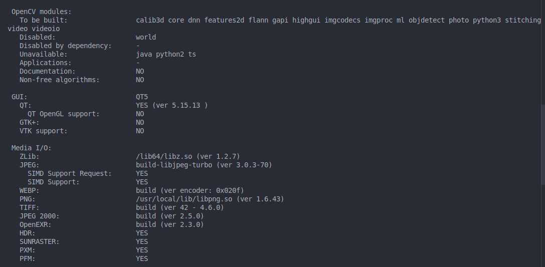

Now after I installed ultralytics to be able to use yolo, I encounter the following problem:
Also here it appears that Gstreamer is no, although in the tutorial I set it to yes and before everything was working ok:
And if I run this command, everything works ok, that is, I can see the images from the camera:
gst-launch-1.0 nvarguscamerasrc sensor-id=0 ! nvvidconv flip-method=2 ! xvimagesink
I installed OpenCV once more following the above tutorial but the problem was not solved. How could I solve the problem? I need an urgent answer, I don’t know what to do anymore :((

Also, although Gstreamer in the installation tutorial for OpenCV is set to YES, here it appears that it is set to NO. When I installed OpenCV again, it seemed at one point that it was set to YES, but I see that in the end it still remained on NO.

I solved the problem with TensorRT by reinstalling it. In the terminal I still see version 4.10.0 although in jtop it is 4.9.0 (i still have this problem). But more important now does anyone know how to solve the problem with Gstreamer? Thanks in advance!

Also running this code I found that Gstreamer is installed but I don’t know why I think Open CV doesn’t interpret it properly.
