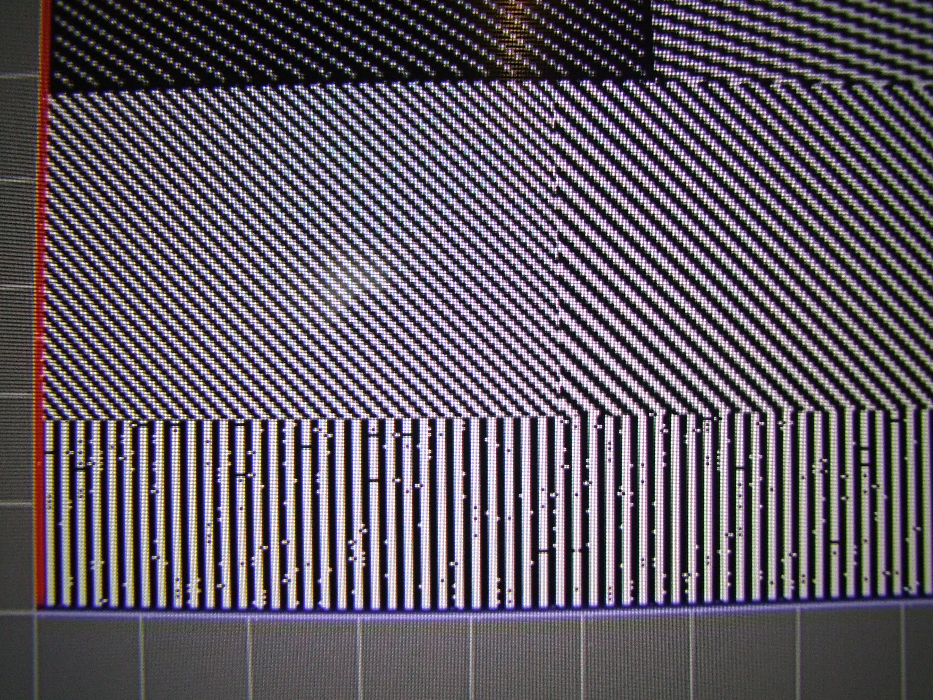

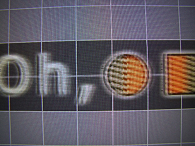

Hi Sandip,
The problem/issue has changed with latest driver 381.09.
The temporal combing/smearing has gone but there is still a problem with 2xAdv DI, still not useable (IMO).
The issue is with stray pixels detached from moving edges.
This problem could have been masked/covered up by the gross temporal combing i.e. could have always been there.
Have attached new photos & video clip of ‘Cheses Slicies’ 1080i50 de-interlacing test track using:-
  • GTX 1050 TI
  • driver 381.09 from ubuntu prop. graphics driver ppa
  • VDPAU 2xAdv DI
  • MythTV playback.
  • custom 50Hz modeline
  • 4K LCD (video card scaling 1080 → 4K native res)
Sorry for the ugly video container (& low res) but that’s only option on the camera.
DSCF3227.AVI (10 MB)
DSCF3225.AVI (19.9 MB)

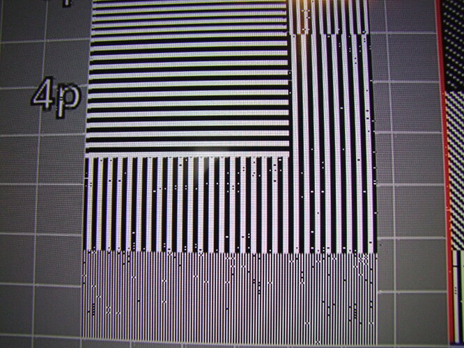

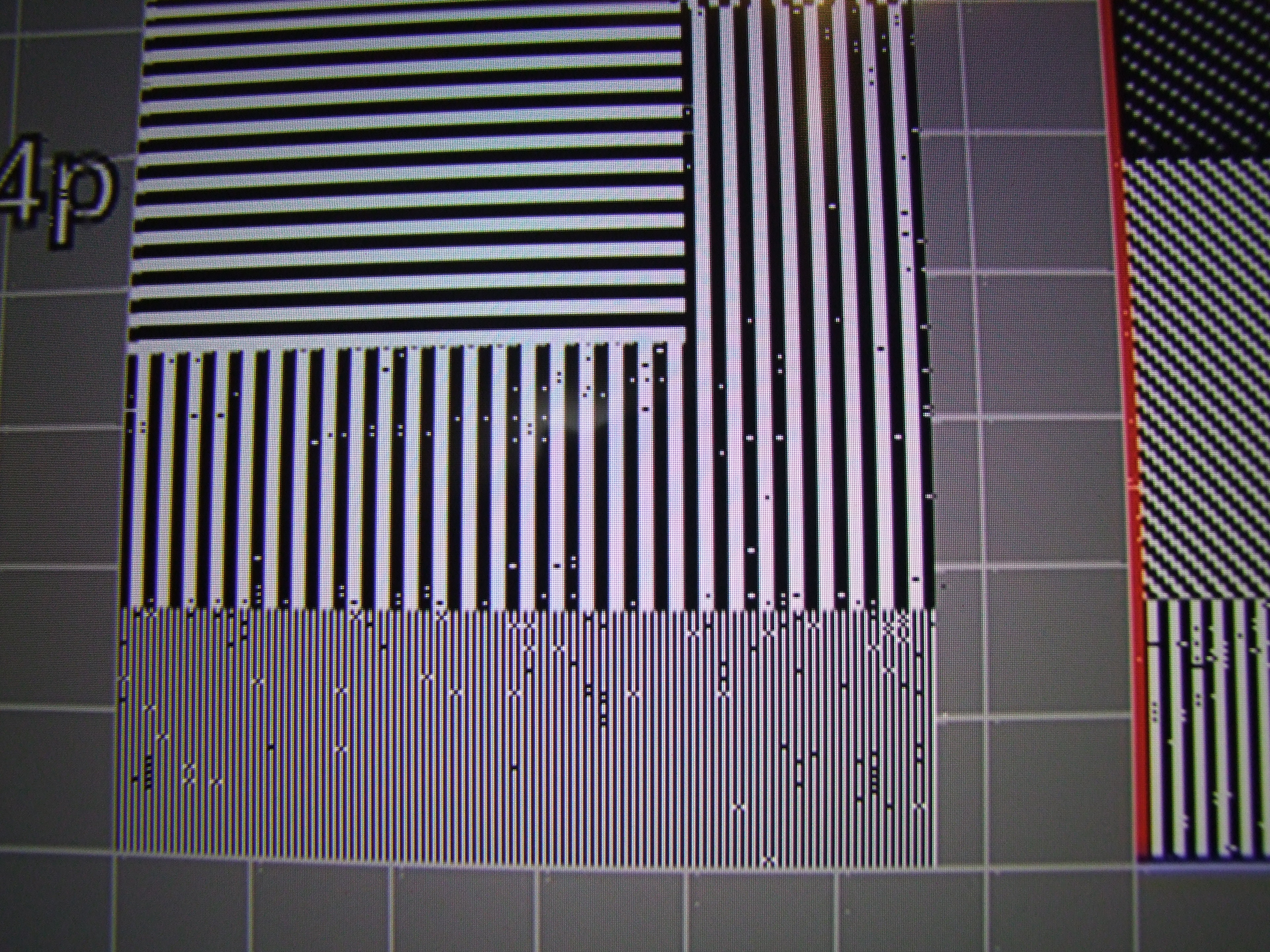

Sandip,
The default MythTV video playback paused state is to render one decoded field of interlaced video.
This is always been annoying/ugly.
So to get better photos, I hacked MythTV source to make playback pause display the full VDPAU de-interlaced frame.
Attached some static (paused) photos of advanced x2 de-interlaced rendered frame.
