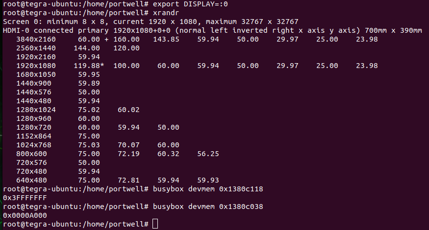

xrandr (ASUS VG279Q1A)

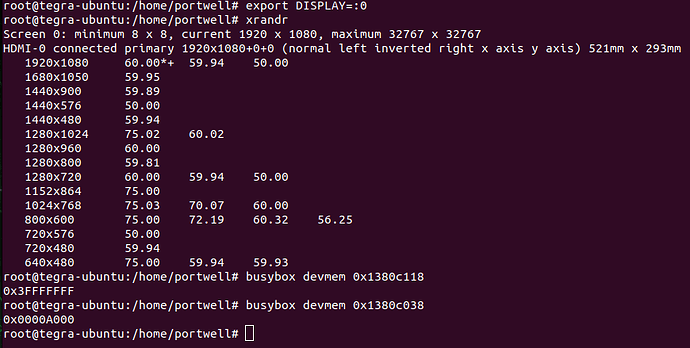

xrandr (ASUS XG32UQ)

hello kevin.chen5,
just for confirmation, can this issue reproduce by reverting the sequence?
for instance,
please try connect to the ASUS VG279Q1A first, and then disconnecting it and reconnecting to the ASUS XG32UQ for testing?
connect to ASUS VG279Q1A first → Display OK,
disconnect and reconnect to ASUS XG32UQ → Display OK,
disconnect and reconnect toASUS VG279Q1A → Hit the issue
hello kevin.chen5,
all right, it seems the failure only reproduced after connect to this 32-inch display.
it might be EDID issue, do you have other display monitor for testing?
or.. could you please try revise display outputs to limit it as 1920x1080@60-fps for testing?
In fact, we already tried several displays as the table below
It’s the only combination to hit the issue.
We also tried to set the display output to Full-HD(1920x1080@60Hz) from UI, it still no display output.
