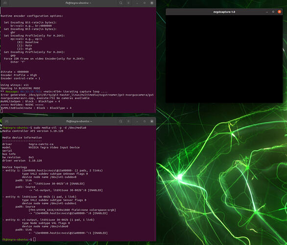

Media topology and formats look good
From media-ctl -p -d /dev/media0:
  • All links are ENABLED
  • Path: lt6911uxe 30-002bnvcsi@15a00000vi-output /dev/video0
From v4l2-ctl --list-formats-ext:
  • 1920x1080@60fps
  • Formats: UYVY, NV16
Everything seems enumerated correctly.

[  196.651691] tegra-camrtc-capture-vi tegra-capture-vi: uncorr_err: request timed out after 2500 ms
[  196.660837] tegra-camrtc-capture-vi tegra-capture-vi: err_rec: attempting to reset the capture channel
[  196.671263] (NULL device *): vi_capture_control_message: NULL VI channel received
[  196.678988] t194-nvcsi 13e40000.host1x:nvcsi@15a00000: csi5_stream_close: Error in closing stream_id=0, csi_port=0
[  196.689638] (NULL device *): vi_capture_control_message: NULL VI channel received
[  196.697350] t194-nvcsi 13e40000.host1x:nvcsi@15a00000: csi5_stream_open: VI channel not found for s
It seems the problem is not the I2C communication or driver probe,
I can successfully read and write LT6911UXE registers via I2C (I2C address 0x2b).The chip probe is OK, and all register values are normal.But I still get the VI capture timeout and VI channel not found error when capturing.

I have run the command mentioned above.
fk@tegra-ubuntu:~$ modprobe rtcpu_debug
modprobe: FATAL: Module rtcpu_debug not found in directory /lib/modules/5.10.120-tegra
Even when using the sudo dmesg command, an error still occurred.
[ 1721.573494] tegra-camrtc-capture-vi tegra-capture-vi: uncorr_err: request timed out after 2500 ms
[ 1721.582660] tegra-camrtc-capture-vi tegra-capture-vi: err_rec: attempting to reset the capture channel
[ 1721.593403] (NULL device *): vi_capture_control_message: NULL VI channel received
[ 1721.601173] t194-nvcsi 13e40000.host1x:nvcsi@15a00000: csi5_stream_close: Error in closing stream_id=0, csi_port=0
[ 1721.611848] (NULL device *): vi_capture_control_message: NULL VI channel received
[ 1721.619563] t194-nvcsi 13e40000.host1x:nvcsi@15a00000: csi5_stream_open: VI channel not found for stream- 0 vc- 0
[ 1721.630323] tegra-camrtc-capture-vi tegra-capture-vi: err_rec: successfully reset the capture channel
By executing the command cat /sys/kernel/debug/tracing/trace > trace.log, the obtained content is as follows:

Thank you for your reply.
The trace log shows doesn’t receive any data from the sensor.
You may need to probe the output signal.
Is this related to the channel configuration? For example, if CSI port channel 0 was mistakenly used as channel 1, or if there was an error in the VI port configuration.
I can’t tell, you need to confirm the port-index/bus-width with your HW connection.
We are using 2 lanes, and we have tested the wiring; no connection issues were found.
CSI0_D0_P → MIPI_lane0_0+
CSI0_D0_N → MIPI_lane0_0-
CSI0_CLK_P → MIPI_CLK_0+
CSI0_CLK_N → MIPI_CLK_0-
CSI0_D1_P → MIPI_lane1_0+
CSI0_D1_N → MIPI_lane1_0-
Dump the device tree to confirm the port-index.
sudo dtc -I fs -O dts -o extracted_proc.dts /sys/firmware/devicetree/base

You should remove the “lane_polarity = 6;“ for AGX Orin.
This property only for Orin NX/Nano
I made the following changes: deleted lane_polarity = [36 00];, changed tegra_sinterface = "serial_b"; to tegra_sinterface = "serial_a";, yet the result was the same as before.

If your port-index/bus-width match to your HW design you real need to check the HW due NVCSI/VI don’t receive any data from the MIPI bus.
For the device tree of lt6911uxe, I referred to the tegra234-camera-p3785.dtsi file.
I replaced the imx219 device with the lt6911uxe at the corresponding position, re-edited the device tree, and kept the same CSI ports and VI ports configurations.
The nvgstcapture-1.0 command can capture images normally, so I believe there is no issue with the hardware link.
After switching back to the lt6911uxe device, the video0 device can still be detected, but the nvgstcapture-1.0 command does not work.
Are there any other available commands?
thanks
Do you mean nvgstcapture-1.0 can see the preview with lt6911uxe?
I don’t think nvgstcaptrue-1.0 able to support YUV format sensor.
1、The IMX219 camera module can display images normally using the nvgstcapture-1.0 tool.
2、The LT6911 video bridge chip fails to display any images when using nvgstcapture-1.0.
3、When executing the command v4l2-ctl -d /dev/video0 --set-fmt-video=width=1920,height=1080,pixelformat=UYVY --stream-mmap=3 --stream-count=1 --stream-to=out.raw for the LT6911, the following errors are shown in the output of sudo dmesg.
This error tell unable capture frame data from the sensor and timeout.
Also the trace log shows doesn’t receive any data.
Please probe LT6911 output signal to make sure the output follow the MIPI spec.
