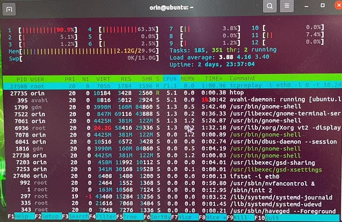

I have the same problem. Two Orin Dev Kits connect to each other. Iperf benchmark is only 5Gb/s. CPU 1 usage 90%.
 ![1651907822(1)](https://global.discourse-cdn.com/nvidia/original/3X/6/c/6c98803467089ab3dd95dd50e21c881a94e5117b.jpeg)
