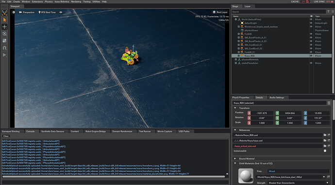

I’m trying to do holonomic navigation in warehouse.
I replaced Kaya\_REB instead of Carter\_REB in “Warehouse Navigation with carter” sample.
added a lidar topic in Kaya\_REB/base\_link and added a REB\_Lidar in Kaya\_REB related to the lidar topic.
When play and create Application from Robot Engine Bridge, the lidar works and moves with the Kaya, then I ran the Isaac SDK part for holonomic navigation, the goal pose and path generated accordingly, but Kaya moved in wrong path.
screenshots:
 ![kaya1](https://global.discourse-cdn.com/nvidia/original/3X/6/7/67ba030a33541fe4e739f924044bd94e7badade8.jpeg)
 ![kaya3](https://global.discourse-cdn.com/nvidia/original/3X/3/3/3379f66556aee0073dab9899d518a2c2f0e410ff.jpeg)
 ![kaya2](https://global.discourse-cdn.com/nvidia/original/3X/1/1/11759a5eccc984a5fab44d20bef8d44cf6167077.png)
I am not sure if it is the right steps to simulate holonomic navigation with Kaya.
1. I didn’t modify the Kaya model to attach a lidar on it, I just added a lidar topic and REB\_lidar and it can detect obstacles.
2. Is that possible to check REB\_HolonomicBase result? input/output messages? or the speed message that send from IsaacSDK and received by IsaacSim omniverse?
Appreciate for any helps!

Unfortunately, Kaya is not yet supported in Isaac Sim. Kaya’s holonomic drive base simulation scripts have not yet been implemented

Hi @eliabntt94 ,
We have this basic example with joystick for Kaya: [https://docs.omniverse.nvidia.com/app\_isaacsim/app\_isaacsim/sample\_kaya.html](https://docs.omniverse.nvidia.com/app_isaacsim/app_isaacsim/sample_kaya.html)
Please see if this is helpful for you.

Hey, thanks for the fast response.
I’ve seen that. But I was looking more at a ROS component (like ROS\_DifferentialBase) or at a REB component so that I can control that through code.
I’ve seen the REB\_holonomic base but it’s not clear to me if it is also omnidirectional. I’ve experimented a lot today so I have a bunch of question that maybe you can answer:
- Can I develop a custom **ROS** component to move my robot? smth like ROS\_DifferentialBase but for my omnidirectional robot. If so is there any tip?
- Is the REB\_HolonomicBase also usable in a omnidirectional way?
- Is it possible to send command to the REB\_DifferentialBase (or any other component) through ros? For this I think I have to dig into rosbridge and the tutorials but I didn’t had time today ;)
- Maybe, you can also check my [other question](https://forums.developer.nvidia.com/t/custom-camera-rendering-layer/183716) regarding the rendering layers for the camera if you have time
Much appreciated,
Elia

One option is to do something like: [How to set velocities of a mobile robot with /cmd\_vel? - #4 by Hammad\_M](https://forums.developer.nvidia.com/t/how-to-set-velocities-of-a-mobile-robot-with-cmd-vel/184639/4)
along with the dynamic control extension to receive a custom ROS message in your extension, and then use `set_articulation_dof_velocity_targets` [Dynamic Control [omni.isaac.dynamic\_control] — isaac\_sim 2022.1.1-release.1 documentation](https://docs.omniverse.nvidia.com/py/isaacsim/source/extensions/omni.isaac.dynamic_control/docs/index.html#omni.isaac.dynamic_control._dynamic_control.DynamicControl.set_articulation_dof_velocity_targets) for the driven joints.
Note that the drive should be set up for velocity control similar to this example: [https://docs.omniverse.nvidia.com/app\_isaacsim/app\_isaacsim/sample\_ros\_turtlebot.html#velocity-control-setup](https://docs.omniverse.nvidia.com/app_isaacsim/app_isaacsim/sample_ros_turtlebot.html#velocity-control-setup)
This is the most general solution as you can use any standard ROS message to pass the data around and write a controller either on the ROS side, or inside isaac sim with full access to physics state information through dynamic control.
