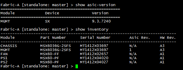

I’m also check show asic-version command.
But show me a firmware only.
show inventory command show me a Chassis revision to me.

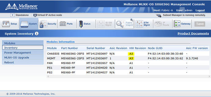

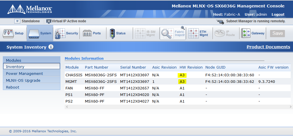

I can find Web GUI information.
I think probably this information equal to show inventory command.
Here is a final question.
What’s the exact my SX6036G’s asic revision.
2 of captures show me a ASIC revision 1.
Can’t my SX6036G’s support 56Gb Ethernet?

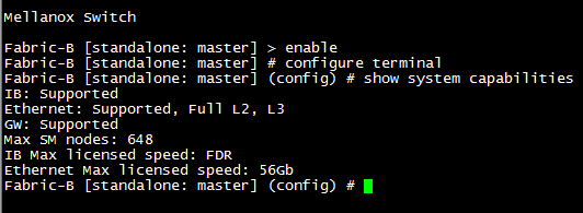

Can you run show system capabilities?
IB: Supported, L2, Adaptive Routing
Ethernet: Supported, L2, L3
GW: Supported
Max SM nodes: 648
IB Max licensed speed: FDR
Ethernet Max licensed speed: 56Gb
Here it is…
Another one is
So it looks like you do have 56Gb/s supported in this switch.
Did you try to configure 56 on the Eth interface?
