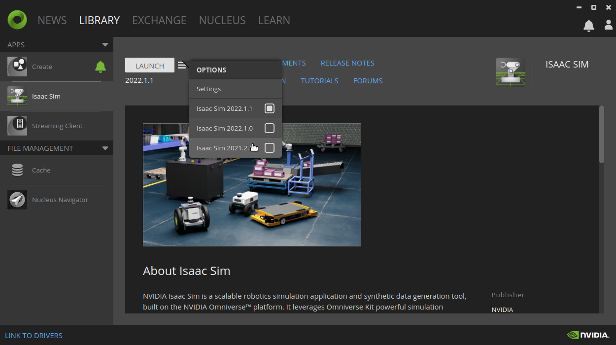

And I can’t start the old version Isaac Sim 2021.1.1 when I click the Launch button. So how can I use older versions.
Hi. We always recommend using the latest Isaac Sim version if possible.
You can still run older installed versions by clicking “hamburger” icon:

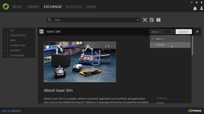

You can also install older versions in the Exchange section by selecting “All builds”:
