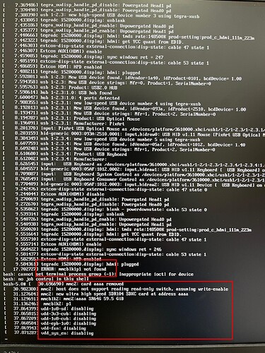

I am using Jetson XNX and custom carrier board.
I am trying to boot from an external sd card.
There is an error “ERROR: mmcblk1p1 not found”.
, How can I make the sdcard inserted into the carrier board recognized as ‘mmcblk1p1’?

The external sd card is activated through dtb modification.
The problem is that the mmcblk number is different every boot.
Thank you.

Sorry for attaching the image
I’ll redirect dmesg and deliver it as a .txt file
First of all, please provide the information below.
1. Copy JetPack 5.0.2 rootfs to sdcard and insert it.
Flash AI module with the L4T driver package by executing the following command:
$ sudo ./flash.sh jetson-xavier-nx-devkit-emmc mmcblk1p1
After flashing is complete, the module restarts and ‘Error: mmcblk1p1 not found.’ appears as shown in the attached photo.
Attempt to remove and reinsert the sdcard to test sdcard recognition
→ Confirmed that the sdcard is recognized as mmcblk2.
- When JetPack 4.x was flashed and booted to emmc, and sdcard was activated with dtb, it appeared as '/dev/mmcblk1p1'.
- Using the same method to activate sdcard in Jetpack 5.x, it appears as '/dev/mmblk2p1'.
Thank you.
