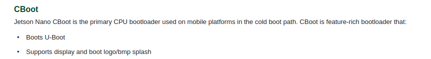

It may not be “misinformation”, but just lacking of precision. For example, what is the definition of splash screen? Some users may enable logo from uboot by themselves and share it on forum and thus some users may think the default logo is from uboot. Or maybe others enable plymouth and once again causing some others think the logo is from plymouth.
We mentioned in developer guide as below.

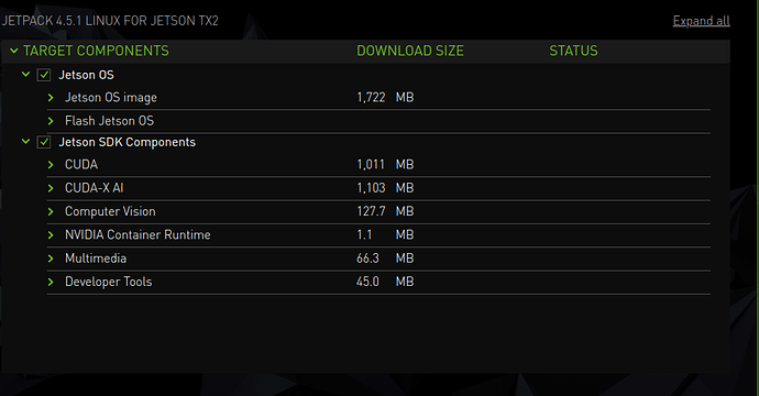

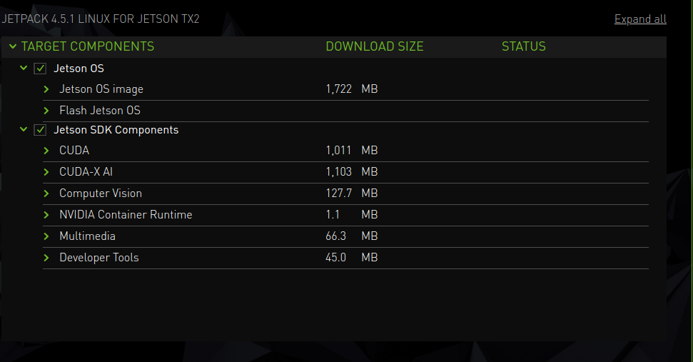

Just do not connect the micro usb cable when running sdkm and it will not flash your board directly. But it will install the pre-built package to your host.
Also, Jetson OS and Jetson SDK can be installed separately. If you want to save time to check logo issue first, just select Jeston OS in below page on sdkm so that sdk will not be installed.
