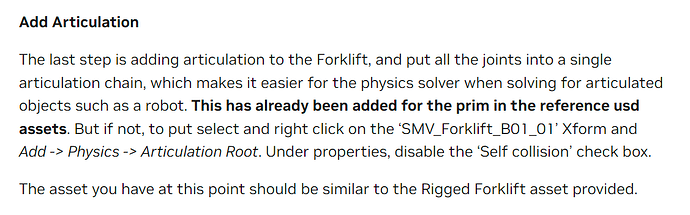

Hi @1878720579 - Here’s the snippet of how to add articulation
 ![image](https://global.discourse-cdn.com/nvidia/original/4X/b/1/8/b18eed85deeb8f9f47785e822fb73fd069ba8080.png)
Here’s the doc link: [5.5. Rigging Robots — Omniverse IsaacSim latest documentation](https://docs.omniverse.nvidia.com/isaacsim/latest/advanced_tutorials/tutorial_advanced_rigging_robot.html)
