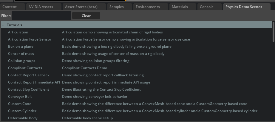

FYI, Nvidia’s definition of tutorial, and mine are different. To me a tutorial is a step by step demo how you create. Your tutorials look just like your
demos here:
I have looked at these demos before, and still don’t know how to add a Joint to a scene, or how to add the fire to one of my projects.
If there was a step by step guide on how these tutorials were built, I think it would help people learn.

Thanks for the feedback, the demos are build from python step by step, you can open the source python file to inspect what is going on.
True its not a UI step by step guide, this is more of a python based snippet that should walk you through what happened.
We are working on video description for each of these snippets, hopefully that gets more information.
Most of the guide for actual UI is here:
https://docs.omniverse.nvidia.com/prod_extensions/prod_extensions/ext_physics.html
Thanks again, we might need to reconsider how to present the core snippets.
