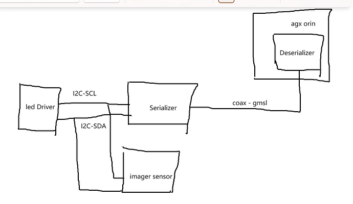

How to add LED device tree on agx orin and it can communication with agx orin via I2C?
I have a led driver chip named max25914, I am referring to the driver instance of lp3592 in the linux kernel to write driver code, but I did not find its device tree, how should I add this led to the device tree to support I2C communication?
the draft of Hardware diagram is as follows:
Please give me some help?

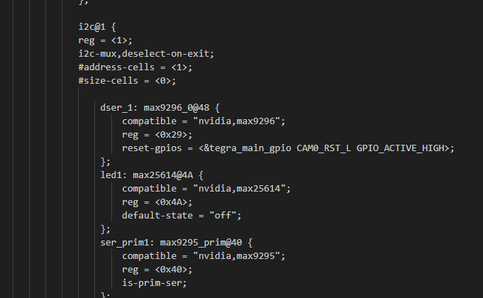

Yes, I referred to this dtsi and added the address of the led, but when I ran the driver to write the led register, agx orin suggested that remote I/O fail.
The device tree segment is as follows:
I wrote the register in the led probe function directly through the regmap_write interface function.
hello 15890986753,
did you confirm you’ve providing power-supply for this i2c device correctly?
What I can confirm is that the imager sensor/serdes has been powered normally and the circuit of the led has not been measured. Do you suspect that the led is not powered correctly? I think it’s not very likely.
hello 15890986753,
power-supply is mandatory for i2c device,
normally, it should be functional after you’ve given power correctly.

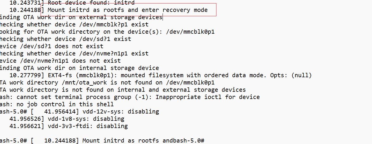

I can’t control my agx orin through the display right now, so the only bad option I have now is to refresh the machine. Can you help me see what the problem is?
Is it in recovery mode from the log? That’s why the display is losing signal, isn’t it?
hello 15890986753,
according to the logs, it looks you’ve corrupted Root file system,
[   10.232136] Run /init as init process
[   10.243731] Root device found: initrd
[   10.244188] Mount initrd as rootfs and enter recovery mode
since it’s corrupted after you updating kernel driver.
please double check Kernel Customization section to examine your steps.
