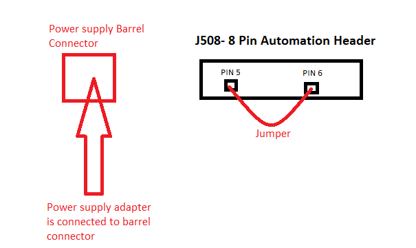

I want jetson agx to boot automatically once it receive power supply on its J2 barrel connector.
Any suggestion how can I achieve it?

Hi @kayccc ,
Point 1:
So, in order to activate auto-power ON, I have to connect a jumper on pin 5&6 (J508- Automation Header) and connect power adapter to barrel connector.
Is my understanding right?
So, by doing that, if I switch -ON adapter power supply, the agx will start boot-up without pressing power-ON button (S501). Is that correct?
Point 2:
One more question, As I am operating the jetson board via DC adapter and it 's feeding 19v dc to it. Can AGX work on 24v as well? AS you know vehicles have either 12v or 24v power supply, how can I feed standard power supply (12v or 24v) without introducing a 19v dc adapter. Can you help me with some inputs?
Point 3: How to boot and shutdown agx via software?
  1. Yes.
  2. The supply range is 9~ 20V.
There is no software command to boot AGX. And the method to shutdown AGX is same as how you run shutdown command on ubuntu.
