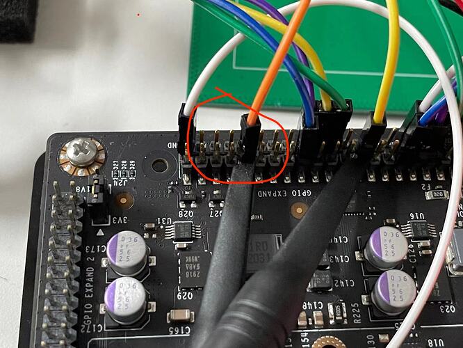

How are you measuring the DMIC clock frequency? Are you probing the DMIC clock with an oscilloscope?

yes, i am measuring by oscilloscope…
it still does not work after executed arecord and amixer command…
