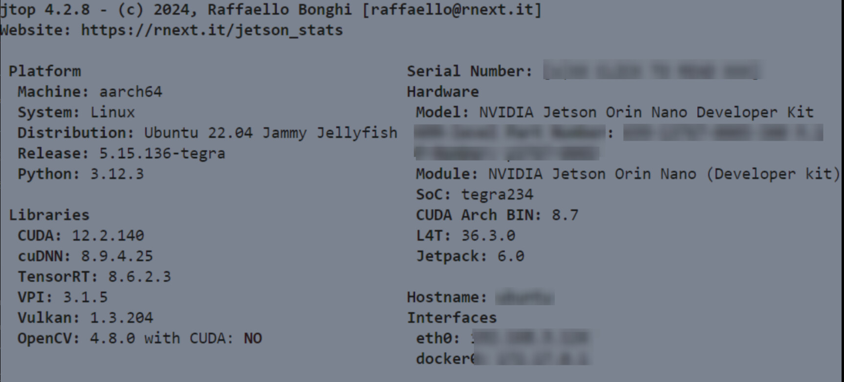

I am using the Jetson Orin Nano 8GB, which is the development board with 40T computing power.
In general, I want to migrate all the previous codes from RK1808, mainly the camera SDK, and compile it. There might be issues with library compatibility or the configuration of the Makefile. I might not have described it very clearly, as this is my first time doing NVIDIA adaptation, and I might continue using the Jetson series in the future.
I have just flashed JetPack, and I am not sure what to do next. Should I directly migrate all the code from the RK1808 development board and then modify it step by step based on the errors, or is there a better approach?

hello B.brick,
please refer to jetson-linux-r363. you should download [Driver Package (BSP) Sources] for public release sources.
you’ll have to download Jetson Linux Toolchain for building, please see-also Kernel Customization for building the kernel and device tree.
in addition,
please install MMAPI package, $ sudo apt install nvidia-l4t-jetson-multimedia-api
you may looking for readme file for the steps to compile the sample app.
