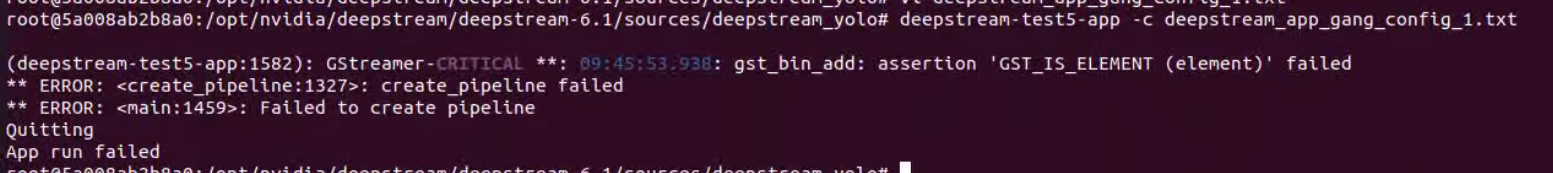

How to configure different Kafka topics for different sources on deepstream
If a video source is configured in [source0], and then a Kafka topic is configured in [sink], the yolov5 recognition result can be sent to the Kafka server normally. However, when I configure another [source1], and then add source id = 0 and source id = 1 in [sink1] and [sink2], the following error will appear.
What is the solution, or how can I configure different topics for different video sources
Is this question shares the same program/setup with topic Why can these sources be displayed in one window after configuring multiple sources on deepstream, but yolov5 can only identify one of them?
Yes, when I change the original configuration file to this, the above error will be displayed. If I delete [sink2], it will work normally

Try this config, it works on my side.

Oh, forgot to enable source-id, need to check.
I modified it according to your configuration file, but this error will still pop up. I can’t find a solution. As long as it involves multiple topics, this error will pop up
Hello! Apologies for the confusion, but DeepStream does not currently support different topics for multiple sources. Different topics for the same stream (with stream-id=0) can be specified with multiple sinks, each pointing to the same msgbroker but with differentn topic names.
