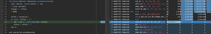

I modified the vectorized kernel to reduce its instruction dependency and do more arithmetic between loads, thanks to the vectorized loads giving me more data at once. I’m kind of shocked that I can still get decent speedups still, with another 20% reduction here.
Interestingly, all the stalls now appear to be in the _shfl instructions:
It says that 98% of my stalls come from “Stall Drain” stalls on the above shfl_down instruction line, which it says are when we’re waiting for memory to be freed after an EXIT code is called. Since the source counter from Nsight_Compute is pointing towards this shfl
instruction, I’m not sure if I can do anything more at this point, since for all I know the EXIT call it’s talking about for the stall is from the __shfl instruction itself.
Either way, thanks for the help everyone! If you have any insight on the above I’d happily take any feedback on removing the above bottleneck if it’s possible at this point!
