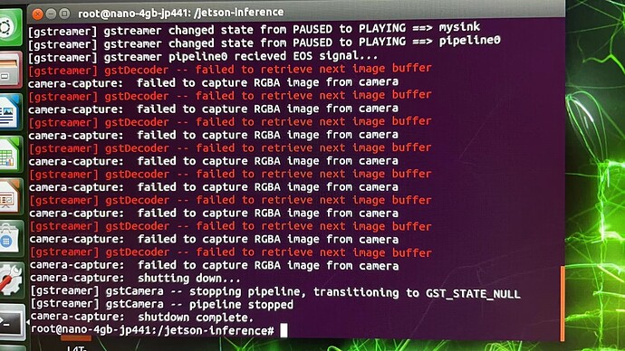

i test the option but it dosen’t work.
when the command is executed, the camera window will come out without images and immediately flashback.
After that the video-viewer tool cannot be opened anymore.
Hmm, can you try restarting the system to bring the camera back? Another thing you can try, is building the project from source (outside of container) with -DENABLE_NVMM=off flag:
$ sudo apt-get update
$ sudo apt-get install git cmake libpython3-dev python3-numpy
$ cd jetson-inference
$ mkdir build
$ cd build
$ cmake -DENABLE_NVMM=off ../
$ make -j$(nproc)
$ sudo make install
$ sudo ldconfig
Then try running video-viewer --input-flip=rotate-180 again (outside of container)
Thanks a lot! It works.
