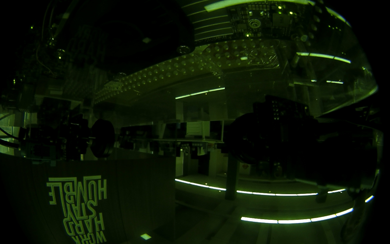

thanks your answer firstly! the way you told me may not suit our problem. because we can’t get the source code of
the dw’s tool.we want to use the dw layer to transplant our code . but in driveworks-0.2.0/samples/src/sensors/camera_gmsl/,we can’t get the right png ( the color is strange green)。 and we use dwSensorSerializer_initialize and set
serializerParams, it doesn’t work.

i have get the dwSensorSerializer_initialize result, it is zero ( means it is successful to init)
I also try your recommended method (use screenshot), but the png file of the origin code saved is partial green (the capture shows on screen by the code is normal)

I get the 2000th frame aims to get the normal camera capture. and in fact, i get a right yuv file ( the y of the yuv file is right and uv is not really). do you know the associate between y field and uv field (the format in ddr)
yuv.tar.gz (3.75 MB)
Hello dota2_black,
Please see below to print out and see what is frameNVMyuv->prop.pxlFormat
External Media
Hope this helps. Thanks.
first thanks a lot of your help : we have successful to get yuv data (a sensor contain four cameras yuv data)
