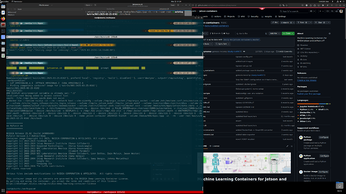

i’m trying to learn how to use buildx and bake to combine multiple images…
this is a proper follow up to my 2 attempts previously https://forums.developer.nvidia.com/t/jetson-containers-keep-exiting-with-error-code-but-not-sure-what-it-means/320624
and this one i guess since the idea was from here https://forums.developer.nvidia.com/t/combining-jetson-containers/292883/9
but turns out… buildx bake is more useful to achieve my goal… but i could not figure out how to get tenssorrt to get installed.
the good news is initially i would somehow need to combine different images from dusty and combine into one image. but apparently it makes more sense to build all from scratch… and thanks still to dusty’s images… i frankenstein-ed his dockerfiles but got stuck at the following. any suggestions?
❯ docker buildx bake --push --file ./docker-bake.hcl --provenance=mode=max --sbom=true

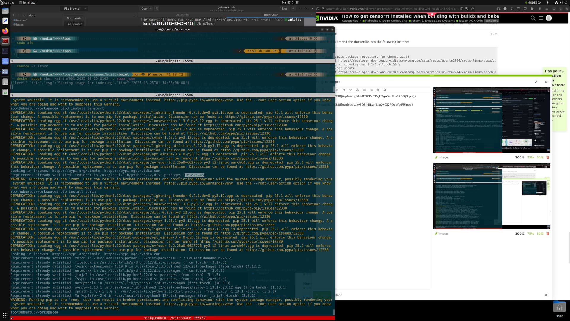

 => ERROR [21/24] RUN pip3 install tensorrt                                                                                                                                  3.9s
 > [21/24] RUN pip3 install tensorrt:
0.727 Looking in indexes: https://pypi.jetson-ai-lab.dev/jp6/cu128
1.857 Collecting tensorrt
2.298   Downloading https://pypi.jetson-ai-lab.dev/root/pypi/%2Bf/6f1/e2beae4c161d3/tensorrt-10.8.0.43.tar.gz (35 kB)
2.332   Preparing metadata (setup.py): started
2.688   Preparing metadata (setup.py): finished with status 'done'
3.218 Collecting tensorrt_cu12==10.8.0.43 (from tensorrt)
3.486   Downloading https://pypi.jetson-ai-lab.dev/root/pypi/%2Bf/0ef/b7ba28afde082/tensorrt_cu12-10.8.0.43.tar.gz (18 kB)
3.506   Preparing metadata (setup.py): started
3.731   Preparing metadata (setup.py): finished with status 'error'
3.741   error: subprocess-exited-with-error
3.741
3.741   × python setup.py egg_info did not run successfully.
3.741   │ exit code: 1
3.741   ╰─> [6 lines of output]
3.741       Traceback (most recent call last):
3.741         File "<string>", line 2, in <module>
3.741         File "<pip-setuptools-caller>", line 34, in <module>
3.741         File "/tmp/pip-install-93mnc6ev/tensorrt-cu12_97430d339ad24026a84446fa6b24f69a/setup.py", line 71, in <module>
3.741           raise RuntimeError("TensorRT does not currently build wheels for Tegra systems")
3.741       RuntimeError: TensorRT does not currently build wheels for Tegra systems
3.741       [end of output]
3.741
3.741   note: This error originates from a subprocess, and is likely not a problem with pip.
3.743 error: metadata-generation-failed
3.743
3.743 × Encountered error while generating package metadata.
3.743 ╰─> See above for output.
3.743
3.743 note: This is an issue with the package mentioned above, not pip.
3.743 hint: See above for details.
Dockerfile:152
 150 |
 151 |     # install tensorrt
 152 | >>> RUN pip3 install tensorrt
 153 |
 154 |     # Clone the repository:
ERROR: failed to solve: process "/bin/sh -c pip3 install tensorrt" did not complete successfully: exit code: 1

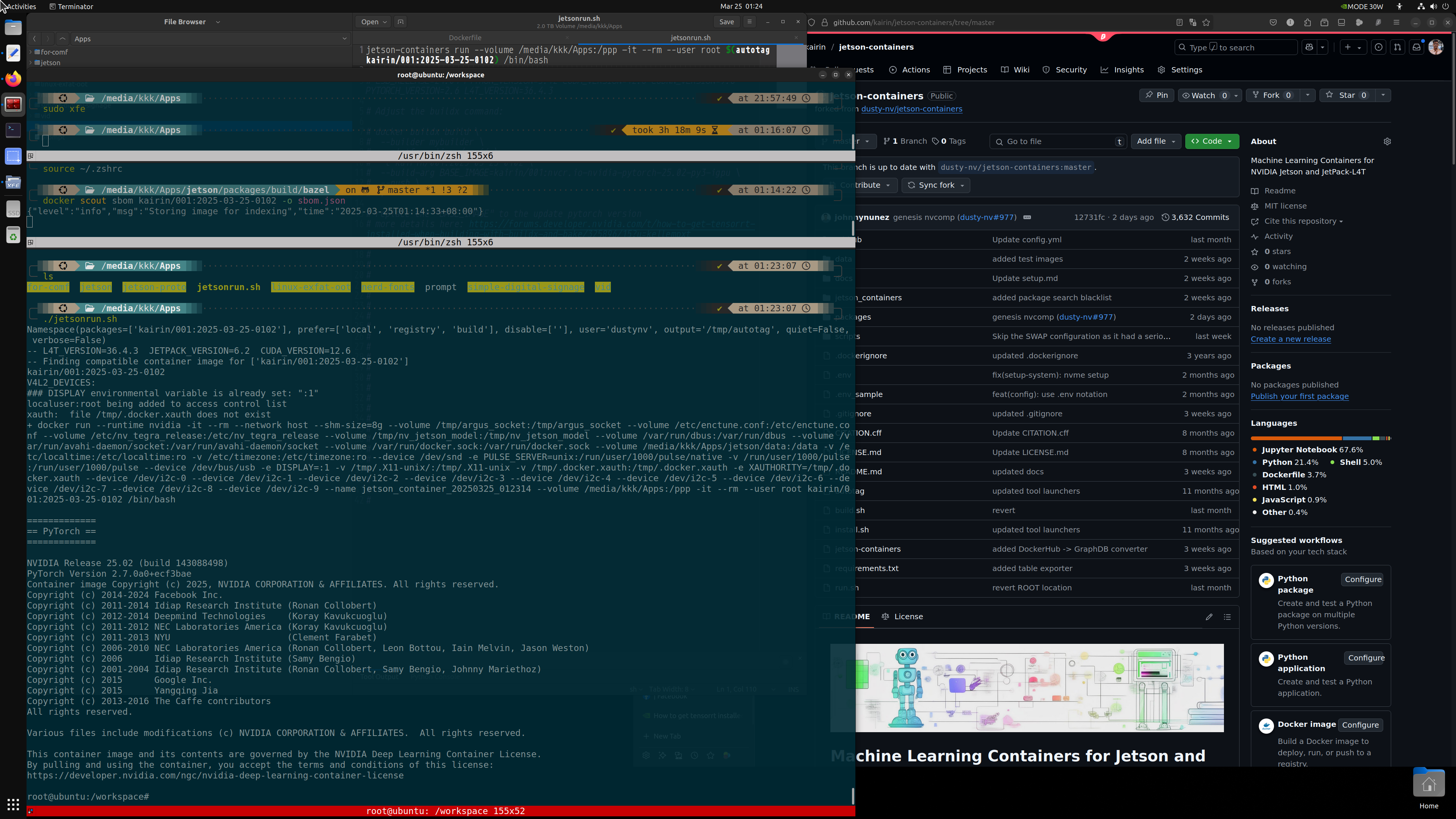

attached my bake file and dockerfile . most of the codes is taken from dusty’s Dockerfile
Dockerfile copy.txt (5.4 KB)

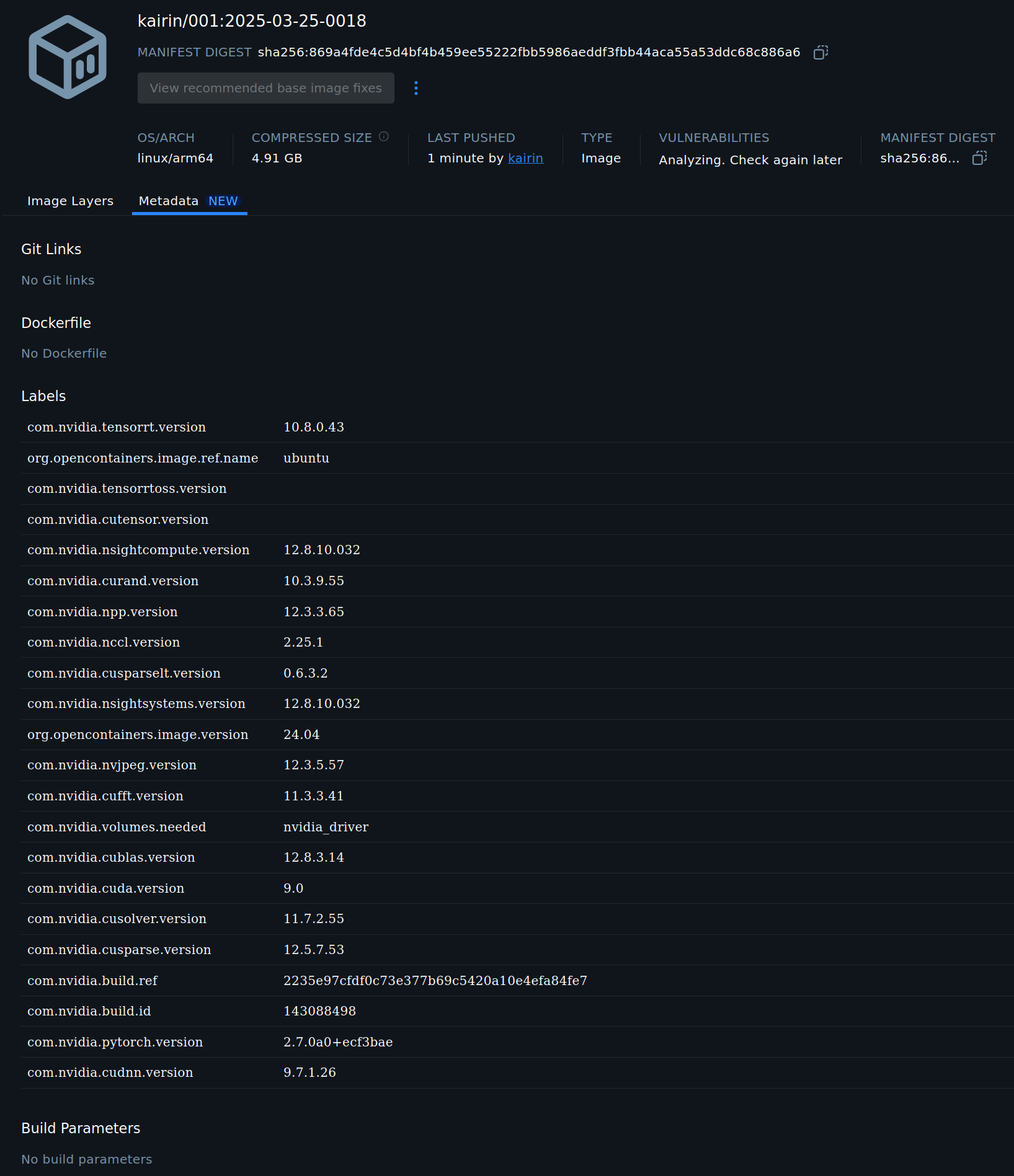

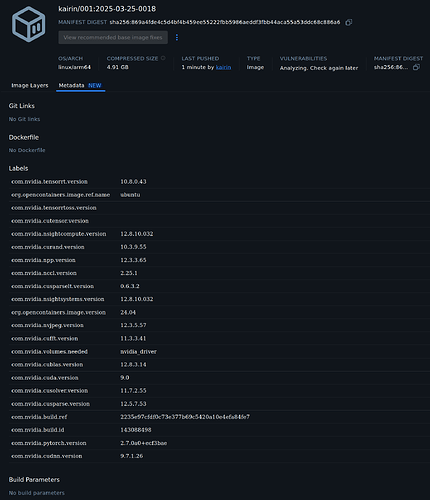

wait… i’m not sure what i did but it uploaded everything? so… that means it works right?
[+] Building 580.9s (16/16) FINISHED                                                                                                                    docker-container:combined

Have you checked this container?
For example, nvcr.io/nvidia/pytorch:25.02-py3-igpu.
It contains the libraries you need so no need to chain multiple containers.
will give a try shortly…
okay.
so these are the steps i took.
  1. obtain the pytorch image from PyTorch | NVIDIA NGC
  2. renamed it.
  3. git pull jetson-containers.
  4. and for example i wanted to try and see if i could build bazel.
  5. i go into the bazel folder within the jetson-containers repo.

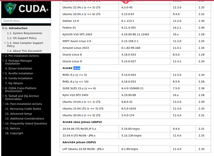

but now i’m thinking it is the wrong cuda-keyring… since i am on the 64gb jetson orin agx dev kit?

╭─░▒▓      /media/kkk/Apps/jetson/packages/build/bazel  on    master *1 !3 ?2 ▓▒░·····················░▒▓ ✔  took 19m 24s    at 00:39:16   ▓▒░─╮
╰─ docker scout attestation add --file sbom.json --predicate-type https://spdx.dev/spdx/v2.3 kairin/001:2025-03-25-0018                                 ─╯
    ! 'docker scout attest' is experimental and its behaviour might change in the future
    ✓ Successfully attached 1 attestation
╭─░▒▓      /media/kkk/Apps/jetson/packages/build/bazel  on    master *1 !3 ?2 ▓▒░·························░▒▓ ✔  took 24s    at 00:40:48   ▓▒░─╮
╰─ docker push --all-tags kairin/001                                                                                                                    ─╯
The push refers to repository [docker.io/kairin/001]
https://hub.docker.com/repository/docker/kairin/001/tags/2025-03-25-0018/sha256-869a4fde4c5d4bf4b459ee55222fbb5986aeddf3fbb44aca55a53ddc68c886a6/metadata
this is what i got:
