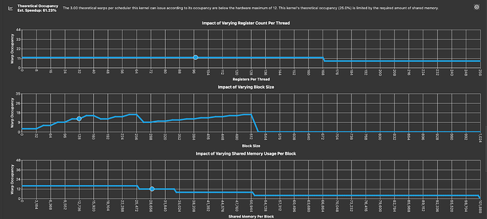

I have a kernel which is using 97 registers with a headroom of 71 registers (obtained from nsight compute, as shown below)
What bothers me is that I have a cute::Tensor that I’d like to be placed in register file, but the compiler decides to place them on local memory, as indicated by both the compilation output and nsight compute profiling output
    352 bytes stack frame, 0 bytes spill stores, 0 bytes spill loads
ptxas info    : Used 126 registers, 25344 bytes smem, 528 bytes cmem[0]
I know that dynamically indexing array is not supported in register files so I have some template programming to statically determine the index.

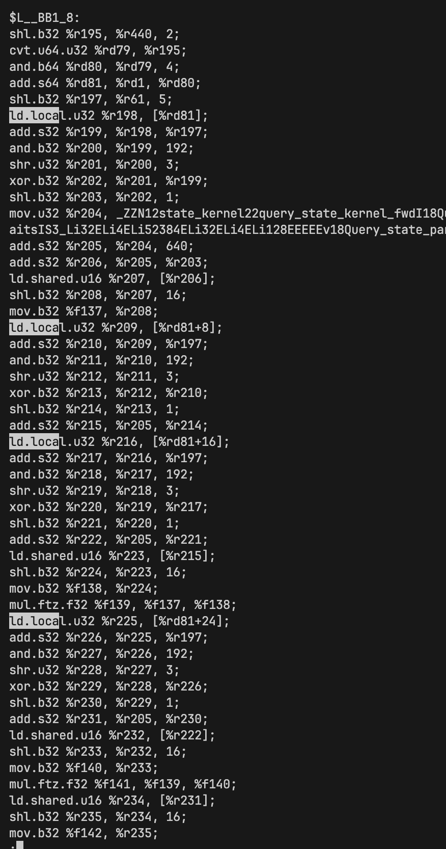

Here’s more relevant calls to ld.local and so on
looking at the ld.local calls, it seems like some runtime address calculation is happening, does that mean despite the meta-programming, the compiler is unable to resolve all access to the data array? But the C++ code is literally calling static_add<DIM>(array, value) where DIM is the index. Why wouldn’t the compiler be able to determine the index?

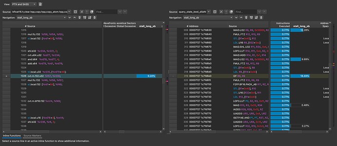

Looking at the PTX code I find it hard to align with what I see in nsight-compute

PTX isn’t the right way to correlate with info from nsight compute
You’ll need to get familiar (somewhat) with SASS in order to come to grips with actual register usage.

How should one look at the PTX output and determine if the compile has trouble with indexing it? I’m seeing PTX output like this
ld.local.u32 %r225, [%rd81+24];
add.s32 %r226, %r225, %r197;
Does this mean the compiler had trouble determining the index statically?
The array cannot be too large
But how large is too large? Perhaps the size limit is some compiler heuristics but what factors are important here?
Please let me know if there’s anything else I should provide to make the problem clearer!
%rd81 is presumably a pointer to the start of the data object. We have to find out where that comes from, and that should indicate how the compiler has transformed the indexing computation. Showing code as an image is always a BAD idea, we would like something searchable. The good thing about nvcc generated PTX code is that it is in SSA form, meaning each virtual register is written to exactly once.
Best I can make it out, %rd81 is a pointer computed at runtime, possibly inside a loop if one assumes $L_881_8 is a loop-starting label. From what I can see here, this would point in the direction of my item (1): The addressing does not seem to be fully resolvable at compile time. One would want to correlate the generated PTX with the source code to try and figure out the details.

I was able to remove all the local memory usage by removing shared memory prefetching in my kernel (which takes up some register space)
$ cuobjdump -ptx chunk_state_bwd_fp16_hdim32_deg4_sm80.o | grep ld.local
what I notice in this version of PTX code is the appearance of the static index offset as global variables that is used later to statically determine the index.
$ cuobjdump -ptx chunk_state_bwd_fp16_hdim32_deg4_sm80.o | head -n 40

This tells me that the meta-programming worked, but it’s probably true that the compiler decides there’s not enough headroom to store the cute::Tensor as registers. But for reasons I’m not fully aware of, compute-sanitizer shows a register headroom larger than the size of the cute::Tensor. It could be the case that in order to fully put the tensor in register, there might be more bytes needed than just the tensor themselves (for example, cute::Tensor might have internal indexing/layout variables, etc)?
Anyway, I think this issue is fixed, thanks @njuffa @Robert_Crovella @striker159 !
