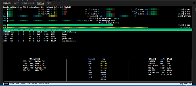

Current Performance
With 67 Cameras @ 10 FPS each (670 FPS total):
  • GPU Utilization: 63-65% (GR3D_FREQ @ 1287-1300 MHz)
  • GPU Memory: 2.66 GB / ~60 GB available
  • CPU Usage: 329% of 1200% (27% total utilization)
  • RAM: 8.1 GB / 62.8 GB (13%)
  • EMC (Memory Controller): 23% @ 3199 MHz
  • Power: 19.3W GPU + 7.8W CPU = ~34W total
  • Temperatures: GPU 62°C, CPU 65°C

  1. Why isn’t GPU utilization scaling beyond 65%? Is there a TensorRT stream/context bottleneck?
  2. Are there CUDA stream configuration options in ONNX Runtime TensorRT EP that could help?
  3. Is OpenCV VideoCapture single-threaded for HLS decoding? Could hardware NVDEC help (currently shows “off” in tegrastats)?
  4. Memory bandwidth seems underutilized (23%) - is this a synchronization issue between CPU/GPU?

Could you share how you read the camera with OpenCV?
Do you use the GStreamer SDK?
Please also try to remove the inference part to see if the limitation comes from the camera or web streaming itself.

No, I don’t use GStreamer SDK
I tried to use a larger model. Although it used maximum GPU resources, But I still saw this error when reading 69 cameras. (I don’t see it if I only use 4 cameras.)
Based on the error, it looks like you are hitting the decoder limitation.
Have you tried to turn off the inference to see if it also drops frames at the 68+ camera?
