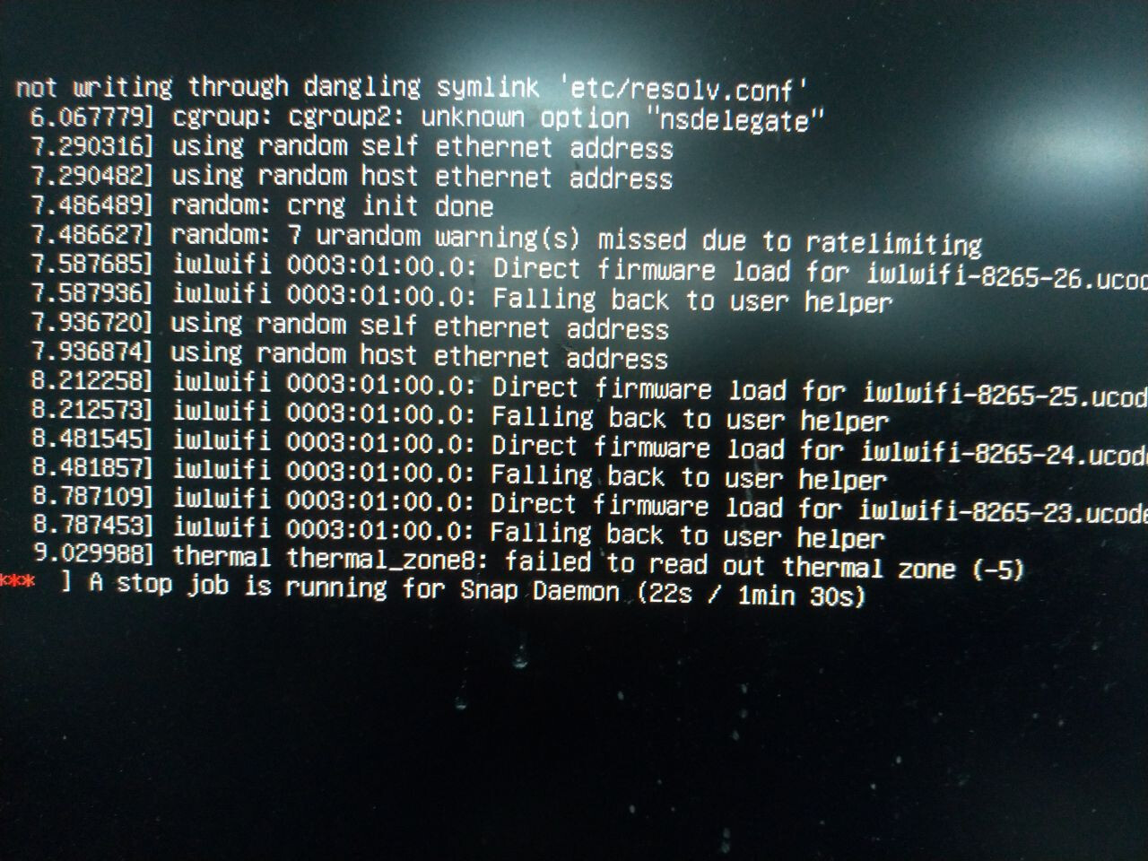

Hello! We didn’t understand how this happened, but after creating a backup, nvidia jetson AGX can’t boot correctly (see the image)
Is there a way to boot from a live cd and restore data from the home directory?
If your backup image without problem try to flash whole device.
Unfortunately, the OS was broken when we did the backup. I would like to connect to emmc and read the information if it is saved.
Maybe it’s possible to boot from something like a live CD?
The problem is that there was not enough memory for the backup and the OS could not start (not enough free space). The ssh connection worked all the time.
