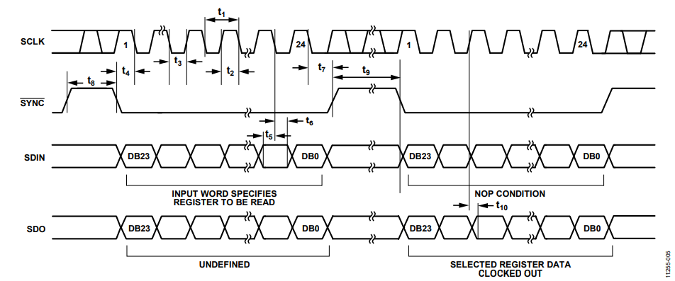

My device is Nvidia AGX Xavier. I want to use the SPI to transmit some data to DAC module, which need 24 bits SDIN each time. However, I don’t know how to revise the SPI dts file to transmit 24 bits data.

In addition, that is the 24 bits data transmitting
Linux does not support 24 bits. It supports only 16, 32 bits.

But I found SPI official manual which said SPI can transmit size 4.8.16.or 32 bits for packed or 4~32 bits for unpacked Tx/Rx. So how to revise dtc file to set transmitting data size like 8 bits? Maybe I just need to transmit 3 times to reach 24 bits data.

Do you know about how to set 16 bits transmitting of SPI dts file?
Have a reference to spidev_test for “-b --bpw bits per word”
