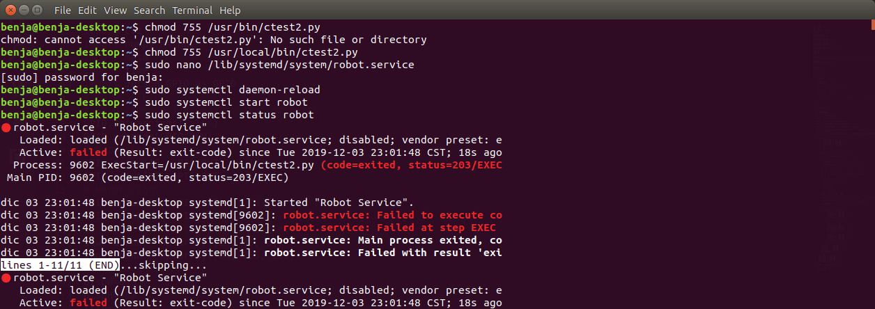

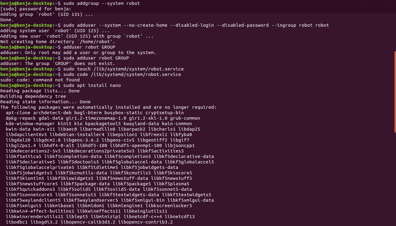

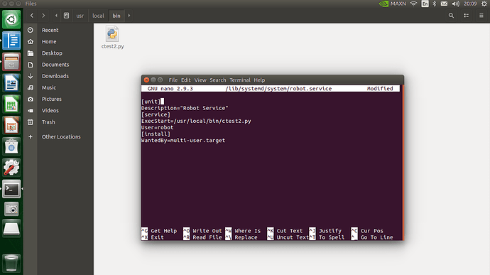

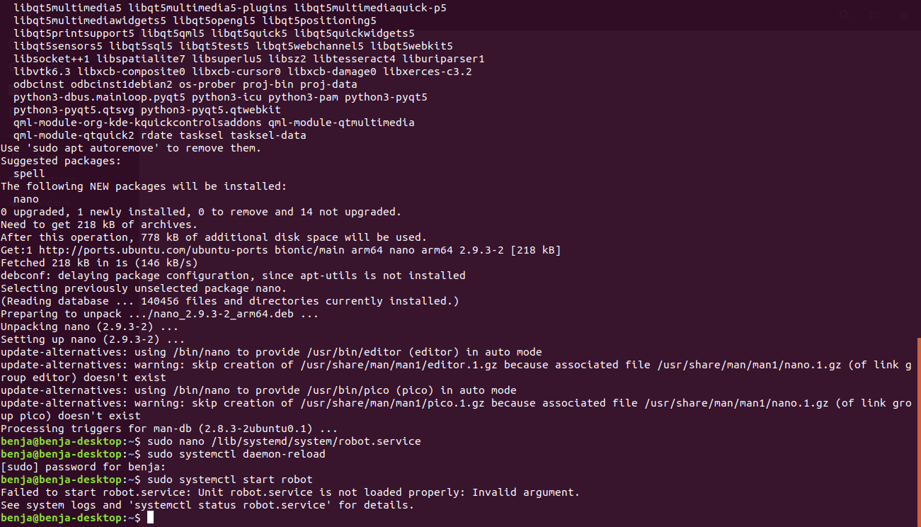

I tried, i think it didnt work because i couldnt make the adduser robot GROUP, but i dont know.
I had to get nano as you said because “Code” didnt work and added the lines you said.
I am really new to all this, i am sorry if i am slow.
I also added the screenshots of what i did and i’ll add my code just to be sure.

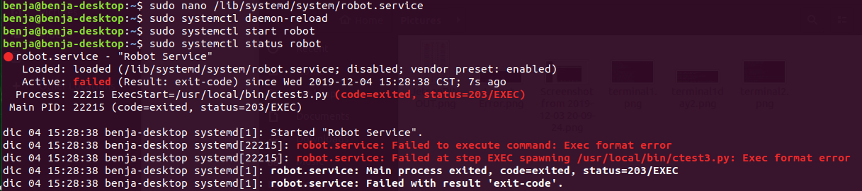

_ **edit** _\*\*\*\*\*\*\*
I tried to redo from the step of: chmod 755/usr/bin/ctest2.py
and i got a different error(which is very long), the image is called latest error in attachements.

 ![terminal2.png](https://global.discourse-cdn.com/nvidia/original/2X/d/df45bfc3d56efb753c097da3ce177d15ee383256.png)
 ![terminal1.png](https://global.discourse-cdn.com/nvidia/original/2X/4/48c6c383b98056a1fc24b3d809ee9b19d4d6fb5f.png)
 ![Latest_Error.png](https://global.discourse-cdn.com/nvidia/original/2X/a/a29c78b845e95f7f80e6cb5f5653a3466599fa4e.png)
 ![Screenshot from 2019-12-03 20-09-24.png](https://global.discourse-cdn.com/nvidia/original/3X/2/5/25f4e17fdec1cf2bfafd642be308dd18fd9ccbe2.png)

That looks fine except the GROUP part. I should have been clearer. Where I wrote “where GROUP is the group you want to add the user to”, i meant that you replace GROUP with whatever gruop you need. In your case you should probably add your user to the “video” group and the “gpio” group.
Example output from my terminal:
```auto
$ sudo adduser robot video
Adding user `robot' to group `video' ...
Adding user robot to group video
Done.
 $ sudo adduser robot gpio
adduser: The group `gpio' does not exist.
The gpio group _should_ exist on your system since you have jetson.GPIO installed but if it’s not, and you get the same error as above, please follow the [instructions here](https://github.com/NVIDIA/jetson-gpio#setting-user-permissions) to add it, and then re-run “sudo adduser robot gpio”.
 ![](https://global.discourse-cdn.com/nvidia/original/3X/7/7/77aa7e320ea2563b6a91306d4e24f6be5f8f6e3e.png)
The above looks correct. Just save it with ctrl+O and you should be fine.
 ![](https://global.discourse-cdn.com/nvidia/original/3X/7/c/7c77a666886d663484990e6e8f8c6fd59da53588.png)
This one, it looks fine until the end where the service failed to start. To find out why it failed, systemctl is telling you to run “systemctl status robot” (you can leave off the .service) to check the status. I can see you did that here:
 ![](https://global.discourse-cdn.com/nvidia/original/3X/3/3/33001a953550b9218e48a0b95127b1e333d192c1.png)
Unfortunately the terminal output is clipped, so I can’t see all of it.
You can check the full log of your program with “journalctl -u robot”
Please run that command and provide the output.
Aha. The problem may be an incorrect path. If your script is located in /usr/local/bin, the commands to ensure proper permissions should be:
```auto
sudo chown root:root /usr/local/bin/ctest2.py
sudo chmod 755 /usr/local/bin/ctest2.py
If the script is not there, that could be the cause of why it’s not running.

Thanks for arriving!
I read the changes and comments of the code and i think that i understood everything, but what does SIGINT means?
I made a new file named ctest3.py that has all your changes.
I could succesfully add the groups.
I edited the nano script for the new file as:
```auto
[Unit]
Description="Robot Service"

I moved the new file to the correct directory /usr/local/bin/ and deleted the previous one
And added the correct permissions
the new error seems much shorter and it fits in the screen haha, i think we are moving foward

I think that one of the issues above is the following line:
```auto
ExecStart=/usr/local/bin/ctest3.py
ctest3.py is not a binary file, and the OS doesn’t know how to execute it. Typically at the top of your Python 3 file you would place a shebang line:
```auto
#!/usr/bin/env python3
which indicates to the OS that the file is an executable script, and to use Python 3 to launch it. The /usr/bin/env indicates where to look for the python3 executable. You must mark the .py file as executable (as you did above with the chmod). I’m not sure that’s adequate for the ExecStart line in the .service file, but it’s something to try. If that’s not enough, you could try something more formal like:
```auto
ExecStart=/bin/sh -c “python3 /usr/local/bin/ctest3.py”

Everything looks good in the screenshots. The execformat error is due to not having a [shebang](https://en.wikipedia.org/wiki/Shebang_(Unix)) at the top of your file. The first line should be
```auto
#!/usr/bin/python3
Sorry for missing that. It should execute with python3 now.
If it doesn’t, you should be able to just do:
```auto
ExecStart=/usr/bin/python3 /usr/local/bin/ctest3.py
Kangalow’s line should also work. Just make sure you test the service with “start” before you “enable” it on every boot, and make sure you have a way to remotely access your nano so you can turn off the service just in case you need to. Above all, have fun!
