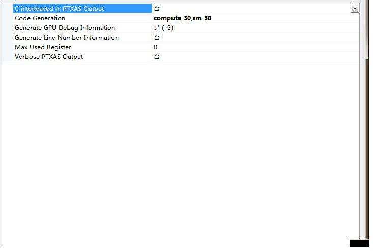

I’ve found that in poject property → CUDA C/C++ → Device → Code Generation, it is compute_10,sm_10 as default, there is no other selection. I typed compute_30,sm_35 into it. But it still does not work.

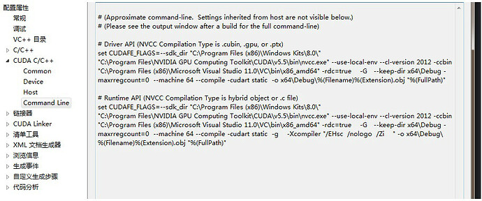

I checked from the project property → CUDA C/C++ → Command Line, and I don’t find any terms like -arch=sm_30, is there anything I should do to apply the setting sm_35?
And cc of GT610 is 2.1
Type compute_30,sm_30 or compute_35,sm_35 in that same option

After I apply those seetings, I can’t find anything change in CUDA C/C++ → Command Line. Does those setting work?
When I click on the triangle on the right side of the blank, there is not selections like compute_** or sm_**, I have to type it manully into the blank. Is there any problem?

Also look in the build output after you compile to see if the -gencode=arch=compute_30,code="sm_30,compute_30" is being sent to NVCC, it will not show up in the project command line settings.
