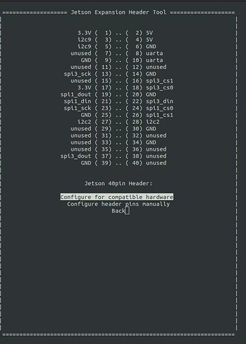

1.I modified the device tree and configured spi1 as slave mode
2.I ran Jetson-IO and selected spi1 and spi3 as follows:
3.I connected the following pins externally:
spi1_SCK<-> spi3_SCK spi1_din<-> spi3_dout spi1_dout<-> spi3_din spi1_cs0<-> spi3_cs0 spi1_cs1<-> spi3_cs1

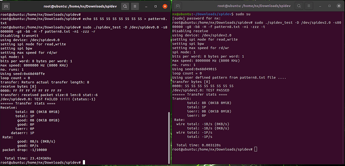

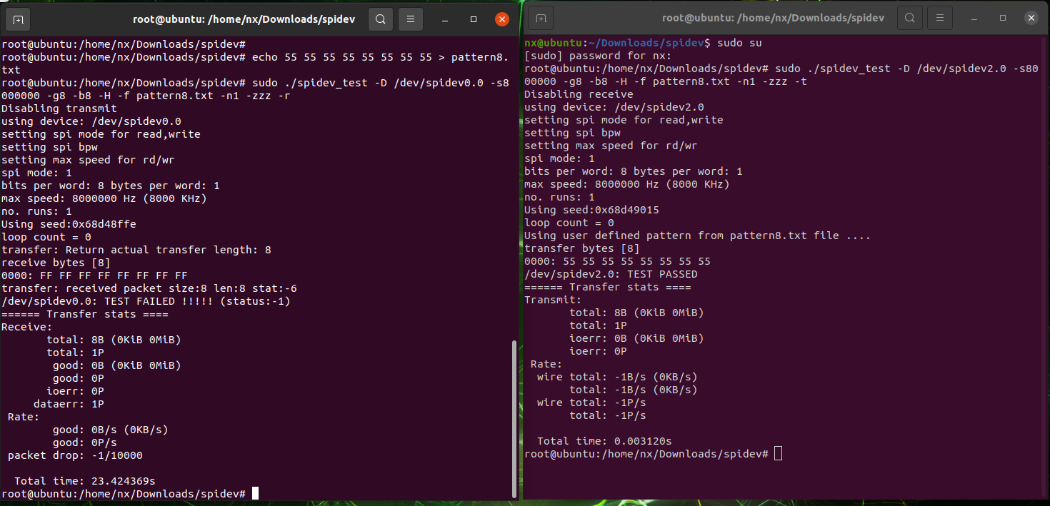

You can simply run the following commands to verify.
$ echo 55 55 55 55 55 55 55 55 > pattern8.txt
$ sudo ./spidev_test -D /dev/spidev0.0 -s8000000 -g8 -b8 -H -f pattern8.txt -n1 -zzz -r
$ sudo ./spidev_test -D /dev/spidev2.0 -s8000000 -g8 -b8 -H -f pattern8.txt -n1 -zzz -t
Because it seems never to finish, I use ctrl+z to stop it, the result is :

You have to run the first command in first terminal, it will keep in waiting state to receive the data sent from master.
Then, you should run the second command in another terminal to send the data.
I run them as you tell me,the result of spi seems incorrect.
From the screenshot you shared, it seems the data has been sent correctly but the slave received all 0xFF.
Could you get a scope to measure the data on MOSI to check if it keeps high during the data transaction?
Please also share the full dmesg and device tree for further check.
