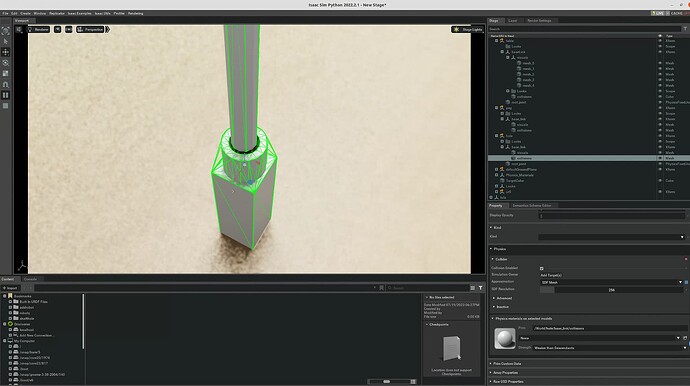

I can found the Physics → Collider now, But the peg still can not insert into the hole
I’m glad to hear that you were able to change the collision type successfully.
Can you enable collision_visualization to check the collision mesh? You can enable collision_visualization by clicking on the eye icon in the top-left corner and then selecting Show By Type → Physics → Colliders → All. This should visualize the collision mesh as a green Triangle Mesh. Please take a look at the Collision Mesh and verify if there is a proper hole on the “hole” side.
Thanks,
I find that the collision mesh of the hole was convex, then I change the Collider setting to SDF Mesh in the visuals stage, and the peg can successfully insert into the hole!
However, when I try to import a smaller hole, the peg still can not insert to the hole.
If it’s alright, could you please provide me with the URDF files for the Peg and Hole, as well as the corresponding STL files? Based on the images I’ve seen, it seems that they haven’t been converted to SDF Mesh yet. I would like to try converting them myself and verify the results. Once I have confirmed it, I will attach the USD files to this thread.

The reason I thought the objects were not converted to SDF was because when I created an Insertion task in the past using SDF, the Triangle Mesh was provided in finer detail, and the mesh appeared on the object’s surface. However, when I looked at the images you provided, it seemed like the mesh was positioned away from the object’s surface, which led me to believe it wasn’t converted to SDF.

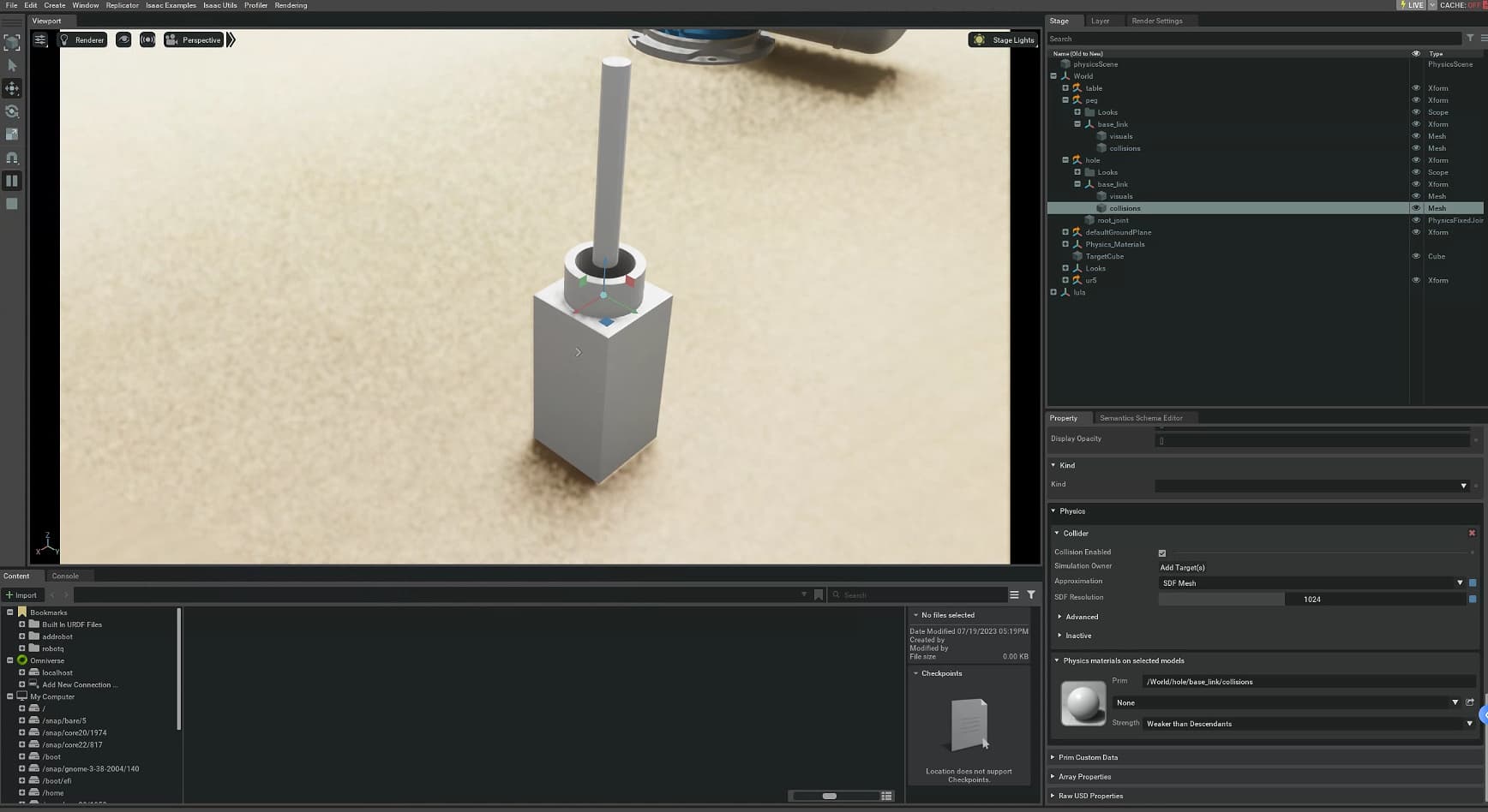

The current mesh now is like this, I don’t know whether it provided fine details?
Because even if I increase the “SDF SOLUTION”, the mesh seems not change. Furthermore, when I set the value to 2500, the mesh disappeared…
hole (2).STL (7.8 KB)
I see.
It doesn’t seem to have the level of fine detail I expected. In my case, I would directly open the STL file in Blender or similar software and subdivide the mesh to make it finer.
