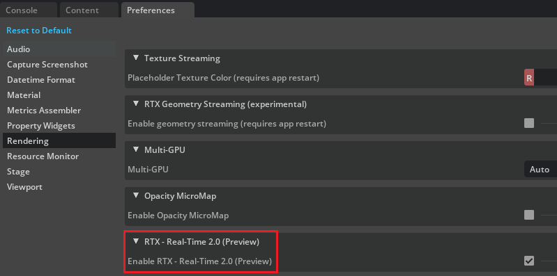

Hi @Richard3D , I didn’t find RTPT Experimental Renderer feature.
Do you mean RTX Realtime2.0(preview) ?
Yes correct
