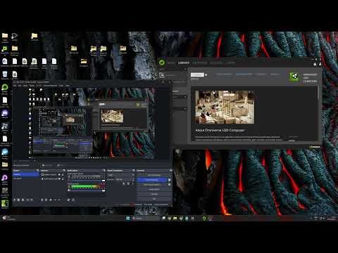

I have animated my camera in Kit 106.
It was a character, and that look best when rendered as path traced.
Now the rendering is most efficient on multi gpu so I have 8 x L40S at AWS.
But that VM runs only Composer ( that is another case here on forums, working on it )
So I need to open my scene in Composer 2023.2.5
When I do that, I can see my character is moving along just ok, since its USD from iClone8 but the camera that I animated in Kit 106 is not moving. Only the camera from iclone is moving.
Here is a video about all this, please see:
So how can I bake my camera movements and focal settings so I can see that camera movement in Composer 2023.2.5 ?

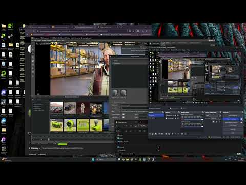

When I open the scene, I see this error message in Composer 2023.2.5:
Pekka
You can bake the camera movements to an “over” animation file, using the Stage Recorder. Or you recreate the camera animation in the old version. It is hard for me to help you with such old versions.
I have not seen the other post, but there is no reason any machine cannot run kit 106 or 107 and requires the old version. Where is this post? Why can you not install 106 or 107 to your VMware?
I tried to use the Stage Recorder by following your guidelines.
As you can see from the end, no good.
I would like to have a tutorial how to use this tool. Is there a such available?
