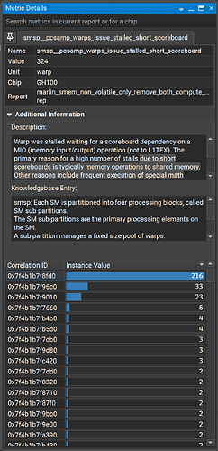

I’m currently profiling a CUDA kernel that implements a GEMM pipeline using cp.async PTX instructions to load matrix data on H100. To evaluate performance, I’m periodically reading the global timer (SR_GLOBALTIMERLO) and storing its value in a register, which is later written to global memory.

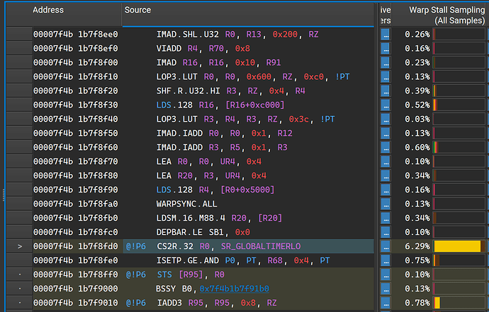

While analyzing overhead using Nsight Compute, I observed that the instruction located at address 0x00007f4b1b7f8fd0 — specifically @!P6 CS2R.32 R0, SR_GLOBALTIMERLO — shows a high metric for short scoreboard stalls.
According to the documentation, short scoreboard stalls are typically attributed to memory operations involving shared memory or frequent execution of special math instructions. However, this particular instruction doesn’t appear to involve either of those cases.
Could you help me understand what might be causing these short scoreboard stalls in this context, and if there are any strategies to mitigate their impact on performance?

The short scoreboards are likely from the DEPBAR which is waiting on a dependency. Some instructions execute then stall the warp resulting in the stall reason on the next instruction.

Thanks for the response! I have one follow-up question. When I compare the code that includes the profiler (i.e., with the instruction @!P6 CS2R.32 R0, SR_GLOBALTIMERLO ) to code that doesn’t use the profiler (i.e., doesn’t have the CS2R instruction), I notice that the DEPBAR instruction is only present in the former case. Does this imply that the CS2R instruction introduces an additional dependency on prior instruction (or at least that the compiler considers it so, possibly because it requires all previous instructions to complete before the global timer register can be sampled)?
The compiler is likely treating the timestamp read as an instruction fence requiring all work submitted before the timestamp to complete. The compiler has to apply some special logic to timestamp reads or they would be optimized to completely useless locations and not measure what one would expect.
