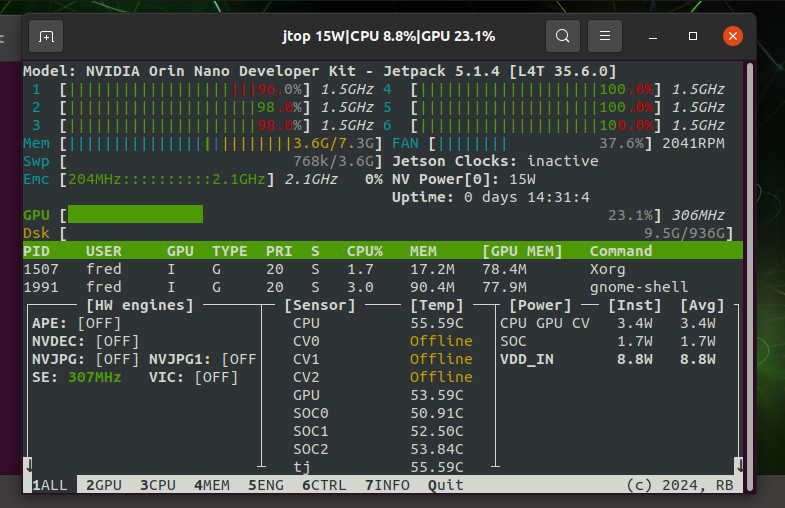

This will get you going, it is building as I am typing.
native build.
$ sudo apt install libssl-dev
Next, since they don’t have a “clean” with the script just restart it.
cd /home/fred/orin-bsp/public_sources/Linux_for_Tegra/source/public
./nvbuild.sh
Update:
  LD [M]  sound/soc/tegra/snd-soc-tegra210-sfc.ko
  LD [M]  sound/tegra-safety-audio/safety-i2s.ko
Kernel sources compiled successfully.
fred@orin1:~/orin-bsp/public_sources/Linux_for_Tegra/source/public$
