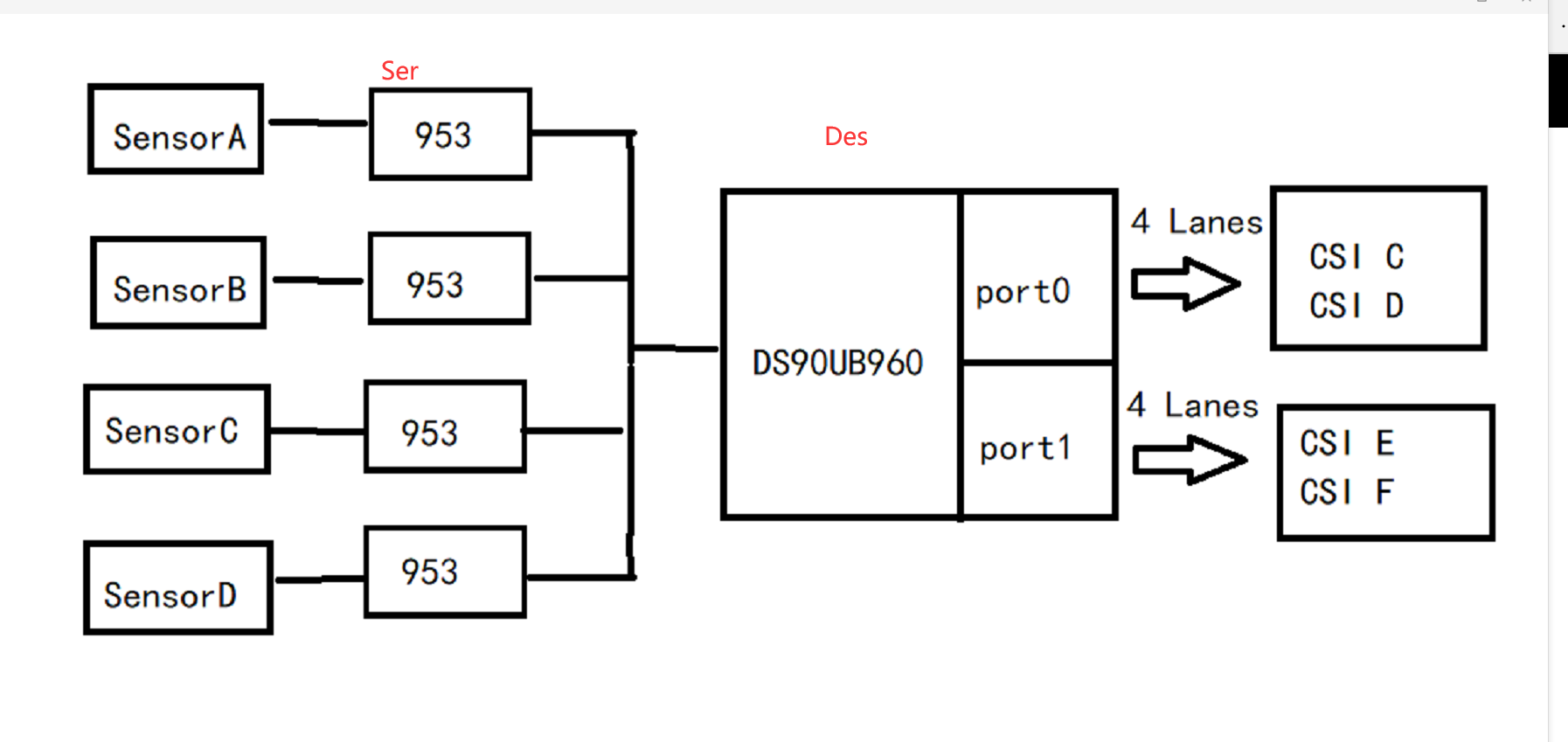

Recently we are using AGX Xavier for development.
We connect four sensors to the platform.
It likes below:
In 960 port0 interface, we have successfully obtained the image data of four camera sensors.Each camera data is obtained from the video 0-3 of the dev node。

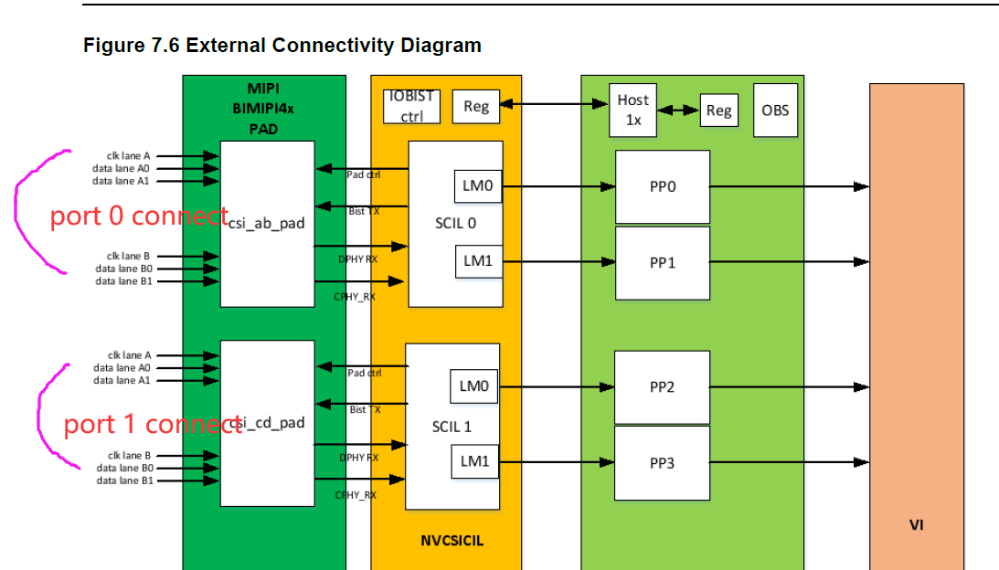

960 chip has data mirror function. We want to get the same camera data from 960 port 1 and share it with another Mipi port。Just like the hardware connection of port1 in the picture above。In short, the data of the four cameras are transmitted to two separate 4 lanes Mipi ports to share the data of the underlying cameras
But how can we separate the camera data in Mipi? Do we need to register new video nodes(eg: video4-7) Can you give me some guidance?
BRs
thanks
Yes need new video nodes for the port1. Just treat it as another four sensors connect to port1.

The four sensors on port0 are implemented based on imx390,
For another four sensors on port 1,Can I use the same driver framework to register 8 video nodes(like: max9295,max9296 driver model ?
In that case, I just need to modify the DTS file
BRs
thanks)
Yes, you can just modify the dts to support it.

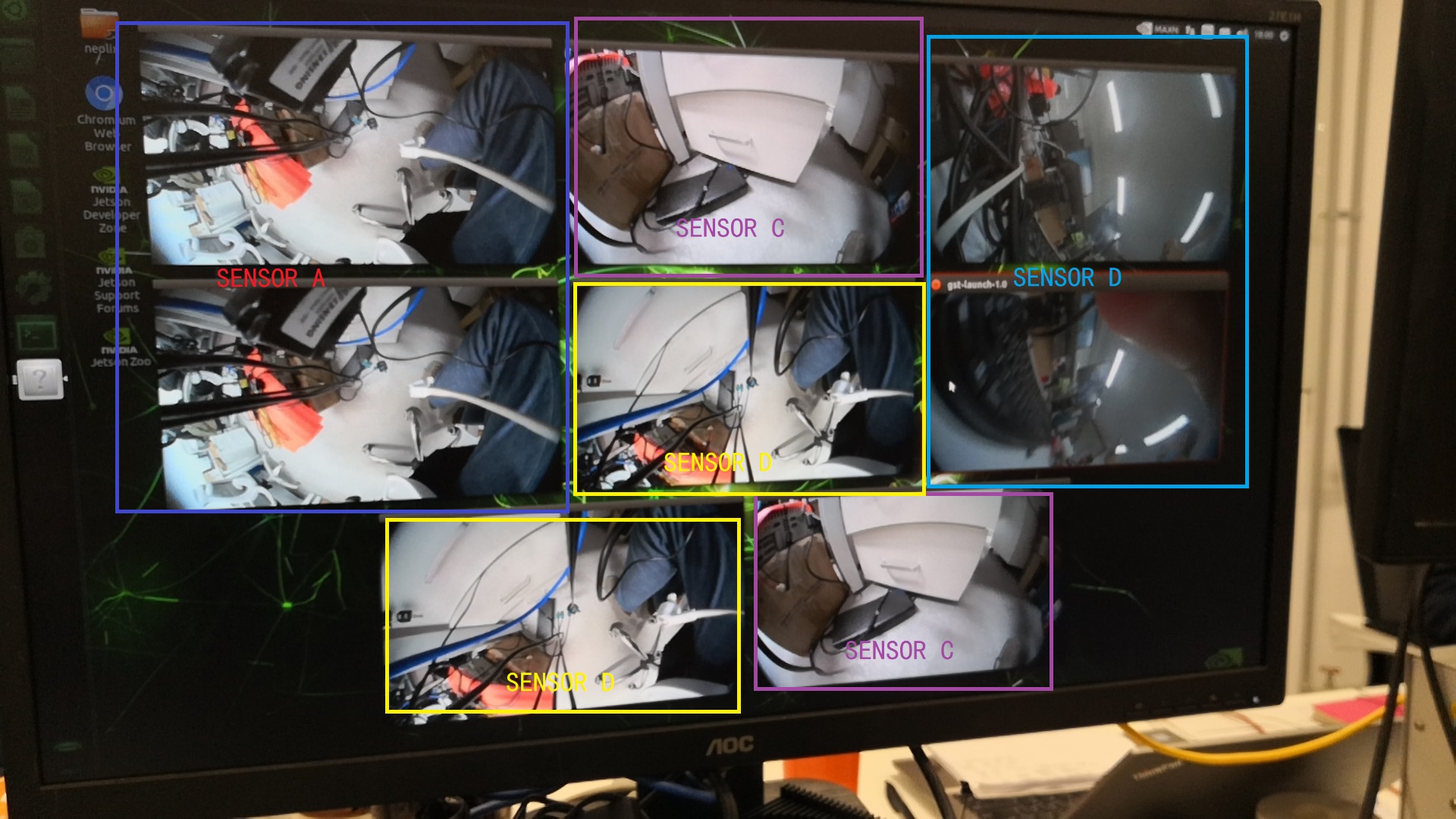

I’ve implemented this feature.
it likes below:
The preview display of the first three channels of data image is normal.(sensor a ; sensor b; sensor c is ok)
The sensor d is a little stutters here.

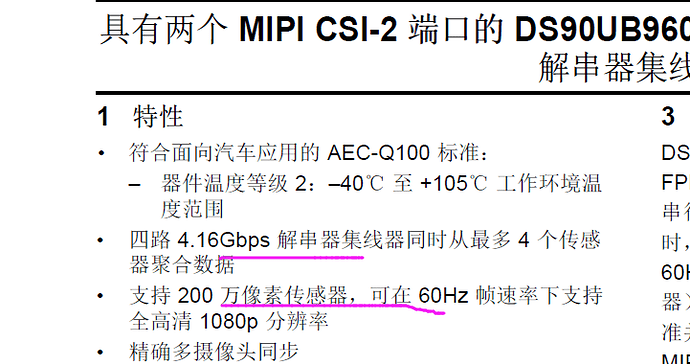

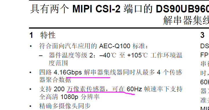

This seems to be caused by a lack of CSI bandwidth.
From the deserializer side,it is enough.
The hardware we use is two 4 lanes MIPI port.
port 0 -----4 lanes MIPI
port 1 -----4 lanes MIPI

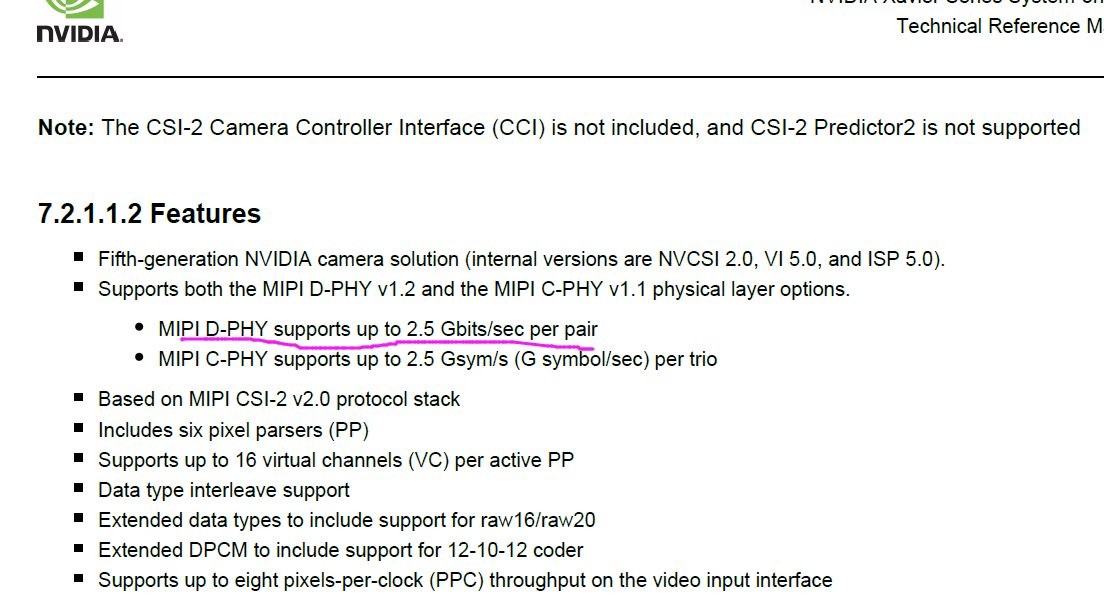

From the nvidia “Xavier_TRM_DP09253002_v1.4p.pdf”,
The description is as follows:
I have a little doubt as follows,it said that “MIPI D-PHY supports up to 2.5 Gbits/sec per pair”,
Q1 ) the 2.5 Gbits/sec per pair is two lanes ot two data line. ?
Q2) According to my understanding, The Maximum CSI bandwidth is 10Gbits/sec for 4 lanes MIPI. Is it right or not ?
Could you give me some advice ?
The actual video effect of the last camera is attached
last-camera-little stutters here .zip (1.1 MB)

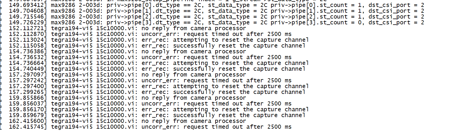

The uart log output as below:
Is this a lack of csi bandwidth ?
Any error in the trace log?
How about try lower frame rate?
Hi ShaneCCC
the trace log was attached.
Now,I had not been try lower frame rate.
trace.txt (250.4 KB)
