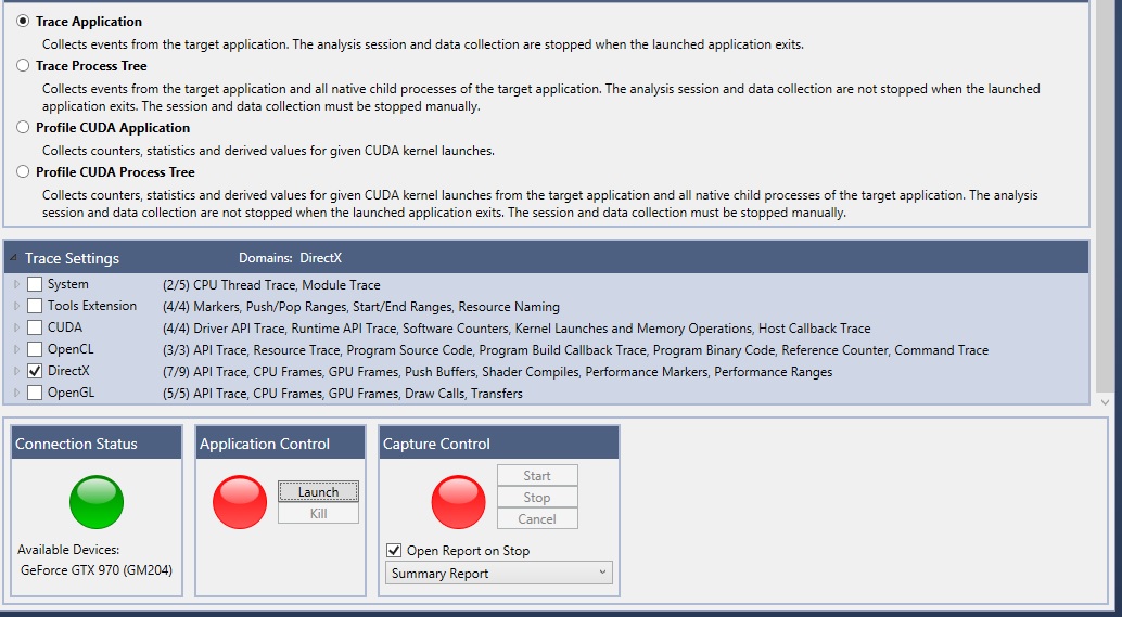

3DMark11 is not launching. See my screenshots. I need to capture 3dmark11 and 3dmark trace and playback that on nsight to capture frames for my research work. Please let me know if I am doing something incorrectly here
Here Issue3 shows the pop up error that comes up when attempting to launch 3dmark11
Hi shabby26,
I am not sure about 3DMark11’s launch logic, but from your sshot, it looks like a multi-process app [3DMark11Cmd looks like a launcher to start new processes]. please try this:
- choose ‘Trace Process Tree’
- check ‘System’ check box
This will allow Nsight to capture the sub processes.
By the way, I have to say the sshot just show you are suing Nsight’s Analysis feature, but not Nsight’s Graphics Debug feature.

Hi shabby26,
I notice you are using GM204, that is not support in your Nsight 4.1, it will be support in the next version.
An
Hi shabby26,
I am not sure about your actually version of Nsight 4.1 (maybe old Nsight 4.1), but maybe you can try to download the latest Nsight 4.1, which should support GM204.
