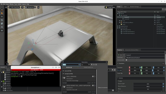

I’m using IsaacLab to set up a simulation environment in IsaacSim, and I want to publish RGB and depth data from a camera created within IsaacSim as ROS 2 topics.
The problem I’m facing is as follows:
While the simulation environment itself launches correctly when I run the script via IsaacLab, the ROS 2 Bridge does not seem to be enabled. Also, unlike the typical IsaacSim workflow, I can’t seem to access or configure the Action Graph when using IsaacLab.
As a result, I’m not sure how to publish the camera data (RGB and depth) to ROS 2 topics programmatically within the IsaacLab framework.
I would really appreciate guidance on how to enable the ROS 2 Bridge and publish camera data to ROS 2 topics without using Action Graphs.

Script:

def _setup_ros_camera_publishers(camera_prim_paths, render_width=640, render_height=480):
try:
og.Controller.edit(
{“graph_path”: “/ActionGraph”, “evaluator_name”: “execution”},
og.Controller.Keys.CREATE_NODES: [
(“OnPlaybackTick”, “omni.graph.action.OnPlaybackTick”),
(“CreateRenderProduct1”, “isaacsim.core.nodes.IsaacCreateRenderProduct”),
(“CreateRenderProduct2”, “isaacsim.core.nodes.IsaacCreateRenderProduct”),
(“RGBPublish1”, “isaacsim.ros2.bridge.ROS2CameraHelper”),
(“DepthPublish1”, “isaacsim.ros2.bridge.ROS2CameraHelper”),
(“RGBPublish2”, “isaacsim.ros2.bridge.ROS2CameraHelper”),
(“DepthPublish2”, “isaacsim.ros2.bridge.ROS2CameraHelper”),
og.Controller.Keys.SET_VALUES: [
# Camera 1
(“CreateRenderProduct1.inputs:cameraPrim”, [camera_prim_paths[0]]),
(“CreateRenderProduct1.inputs:width”, render_width),
(“CreateRenderProduct1.inputs:height”, render_height),
(“RGBPublish1.inputs:type”, “rgb”),
(“RGBPublish1.inputs:topicName”, “camera1/rgb”),
(“DepthPublish1.inputs:type”, “depth”),
(“DepthPublish1.inputs:topicName”, “camera1/depth”),
# Camera 2
("CreateRenderProduct2.inputs:cameraPrim", [camera_prim_paths[1]]),
("CreateRenderProduct2.inputs:width", render_width),
("CreateRenderProduct2.inputs:height", render_height),
("RGBPublish2.inputs:type", "rgb"),
("RGBPublish2.inputs:topicName", "camera2/rgb"),
("DepthPublish2.inputs:type", "depth"),
("DepthPublish2.inputs:topicName", "camera2/depth"),
og.Controller.Keys.CONNECT: [
# Tick → Render
("OnPlaybackTick.outputs:tick", "CreateRenderProduct1.inputs:execIn"),
("OnPlaybackTick.outputs:tick", "CreateRenderProduct2.inputs:execIn"),
# Render → Publish (Camera 1)
("CreateRenderProduct1.outputs:execOut", "RGBPublish1.inputs:execIn"),
("CreateRenderProduct1.outputs:execOut", "DepthPublish1.inputs:execIn"),
("CreateRenderProduct1.outputs:renderProductPath", "RGBPublish1.inputs:renderProductPath"),
("CreateRenderProduct1.outputs:renderProductPath", "DepthPublish1.inputs:renderProductPath"),
# Render → Publish (Camera 2)
("CreateRenderProduct2.outputs:execOut", "RGBPublish2.inputs:execIn"),
("CreateRenderProduct2.outputs:execOut", "DepthPublish2.inputs:execIn"),
("CreateRenderProduct2.outputs:renderProductPath", "RGBPublish2.inputs:renderProductPath"),
("CreateRenderProduct2.outputs:renderProductPath", "DepthPublish2.inputs:renderProductPath"),
except Exception as e:
print(f"[ERROR] Failed to setup ROS camera publishers: {e}")
import omni.kit.commands
omni.kit.commands.execute(
“CreatePrim”,
prim_type=“Xform”,
prim_path=“/World/Cameras”
def run_simulator(sim, scene):
_create_camera_prim(“/World/Cameras/Camera1”, [1, 0, 0.2], [90, 0, 90])
_create_camera_prim(“/World/Cameras/Camera2”, [-3, 1, 1], [-50, -65, -140])
_setup_ros_camera_publishers(["/World/Cameras/Camera1", "/World/Cameras/Camera2"])

[INFO]: TurtleBot RGB-D setup complete.
[ERROR] Failed to setup ROS camera publishers: OmniGraphError: Could not create node using unrecognized type ‘isaacsim.ros2.bridge.ROS2CameraHelper’. Perhaps the extension ‘isaacsim.ros2.bridge’ is not loaded?
Scene setup complete.
Run rqt_image_view to view:
- /camera1/rgb, /camera1/depth
- /camera2/rgb, /camera2/depth
