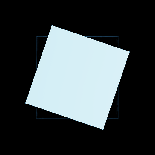

I have made a very simple standalone Python app with domain randomization, but I’m unsure about how I should be using world.step() (or some other method) when capturing the ground truth.
If I don’t add a world.step(), or only 1 or 2 calls I get this RGB ground truth with some rendering artefacts:
When I add a 3rd call it’s correct (sometimes with 2 calls it’s also correct):
How should I be using world.step() to ensure I capture the ground truth correctly? Or should I be using some other method? Full code is here:
