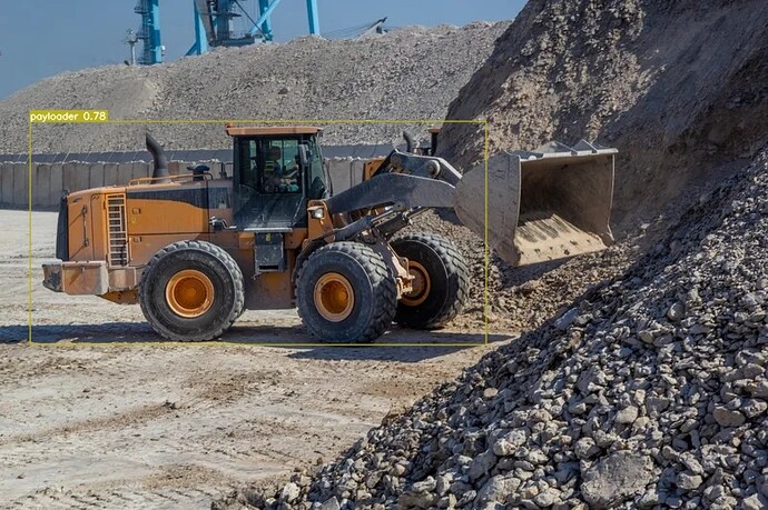

I am running a system with an old Jetson(AGX Xavier) to detect vehicle.
I have been using yolov5 and it worked fine. But now, I want to use yolov7 instead so I found some repositories like this. Although its requirement is TensorRT 8.0+, I first converted yolov7-tiny.pt(official model) to yolov7-tiny.wts then to yolov7-tiny.engine successfully by using the methods they provide. I also tested the engine model that was no problem.
Unfortunately, when I configured a yolov7 model customized by myself(also tiny) in the same way, an exception occurred. The bbox output by the model is not drawn correctly as shown in the figure1.
The command I used to train yolov7 is python train.py --device 0 --epochs 100 --batch-size 8 --data dataset/dataset/train4v7.yaml --img 416 416 --cfg cfg/training/yolov7-tiny.yaml --weights ./yolov7-tiny.pt

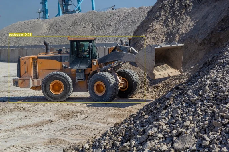

I thought the model itself was not trained well before I checked its pt model. But as shown in the figure2, the bbox of the pt model is obviously drawn correctly.
I guess it’s because my TensorRT version is too old. But it is hard to upgrade it due to it has been deployed to the field.
I’m not sure if my guess is correct. Do you know the real reason? Please tell me.
I saw the repo you referred to also has TensorRT sample. tensorrtx/yolov7/yolov7_trt.py at master · wang-xinyu/tensorrtx. Please try with the TensorRT sample to identify whether it is a TensorRT issue.
Sorry for my late reply.
I will give it a try.
