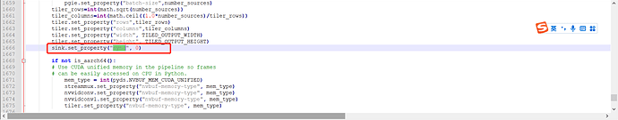

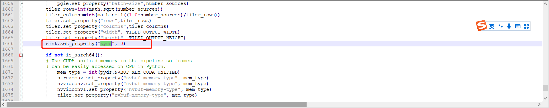

Please set sync=0 to the sink for a try.

Thanks for the response, will let team try this way to do the analysis then update here .
Hello DaneLLL, we had try the feature from your suggest , but under this way the delay still taken, seem no useful, the main problem should It takes too long to analyze pictures, such as how many people there are.
