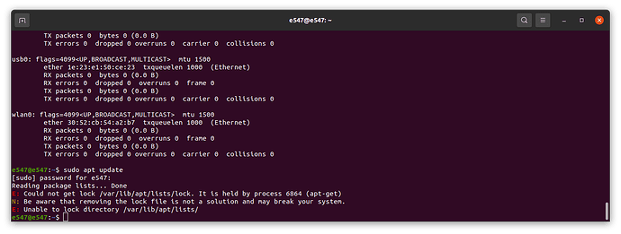

Following is my problem, I don’t install successful components:
SDK Manager is verifying Jetson Xavier NX modules system readiness to install.
  • Disk space.
  • Internet connection.
  • Access to APT repository and ability to install Debian packages with it.
SDK Manager detected your system may not ready for installation, see specific errors below. Once fixed, click ‘Retry’ to verify system readiness again. ‘Skip’ this process may result install installation failure.
Access to APT repository and ability to install Debian packages with it.: Apt repository check failure (1. sudo apt-get update && sudo apt-get check; 2. sudo dpkg --audit). E: Could not get lock /var/lib/apt/lists/lock. It is held by process 2959 (apt-get) N: Be aware that removing the lock file is not a solution and may break your system. E: Unable to lock directory /var/lib/apt/lists/

I have tried the steps you mentioned, but the problem persists. My host PC’s OS is Ubuntu 20.04. The installed JetPack version is 5.1.1.

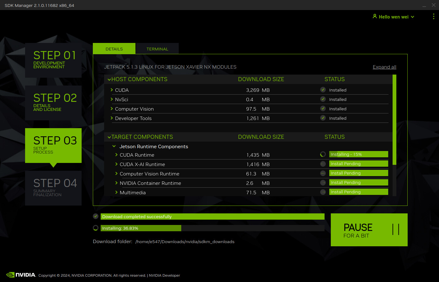

Yes, I can log in to the SDKManger and I only plan to add the components using it on Jetson PC.

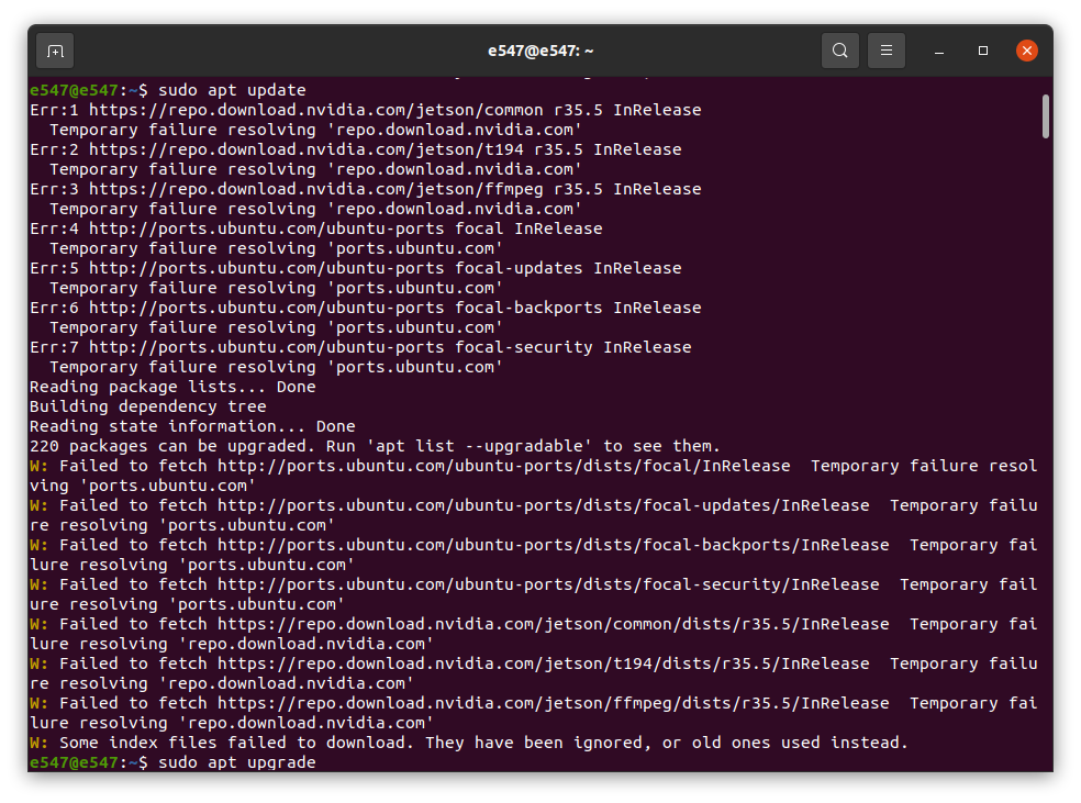

  3. On the Jetson, type sudo apt update (Failed)、sudo apt-get upgrade (successful).
    So, should I fix the jetson update problem first? What do I need to do?
The screen for sudo apt update:
There is a problem with the package state on the Ubuntu of the Jetson. This isn’t specific to Jetsons. A network issue is causing update to fail. Basically, it just happens to be coincidence that it is an NVIDIA package you are updating when you see the failure.
Notice in the failure that it is failing to fetch updates from not only the repo.download.nvidia.com, but also all other repos (in this cause ports.ubuntu.com) are failing. Your Jetson is lacking Internet access.

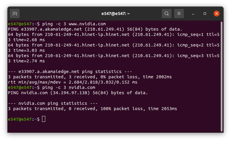

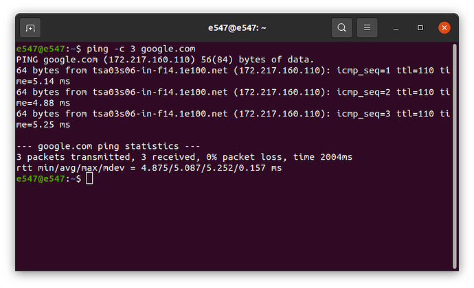

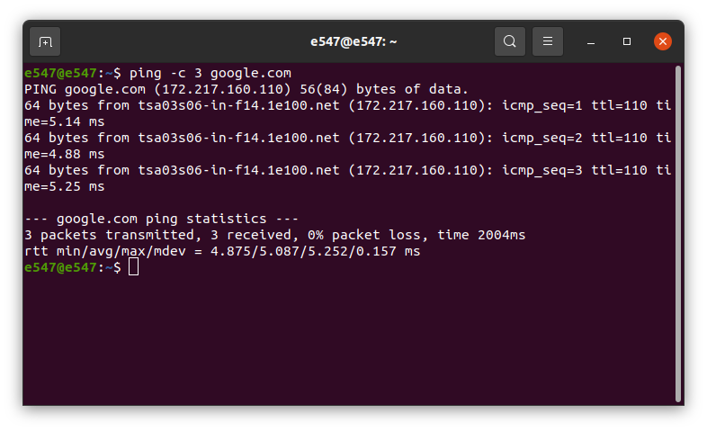

Does the Jetson have Internet access? Can you “ping nvidia.com” or “ping google.com”? Any ping to the outside world?
Note that part of the update->upgrade succeeded only because old index files were used.
It might be possible to set your host PC up to pass through Internet to the Jetson if your only networking to the Jetson is over the USB cable. If there are firewalls or other issues, then those would have to be corrected.
I am using Ethernet on my Jetson PC and can connect to the outside world through the browser.
When I ping www.nvidia.com it succeeds but ping nvidia.com is fails.
