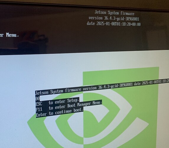

I have Jetson UEFT firmware (version 5.0-35550185 built on 2024-02-20T04:21:22+00:00) - this from boot screen info.
Dump-slots-info command show this:
$ sudo nvbootctrl dump-slots-info
Current version: 35.5.0
According to the doc - JetPack SDK | NVIDIA Developer I have to install Jetpack 6.2 through the “NVIDIA SDK Manager Method”, right?
I should install SDK Manager on host Ubuntu machine and connect Jetson via USB cable?
Question is: my UEFT firmware version 5.0-35550185 is fits for this process?
Because according to the doc - 🚀 Initial Setup Guide - Jetson Orin Nano - NVIDIA Jetson AI Lab
and this - Provisioning Jetson Orin | balena version on board should be version > 36.0.
But I have 5.0-35550185 and 35.5.0, this difference in numbers is confusing…

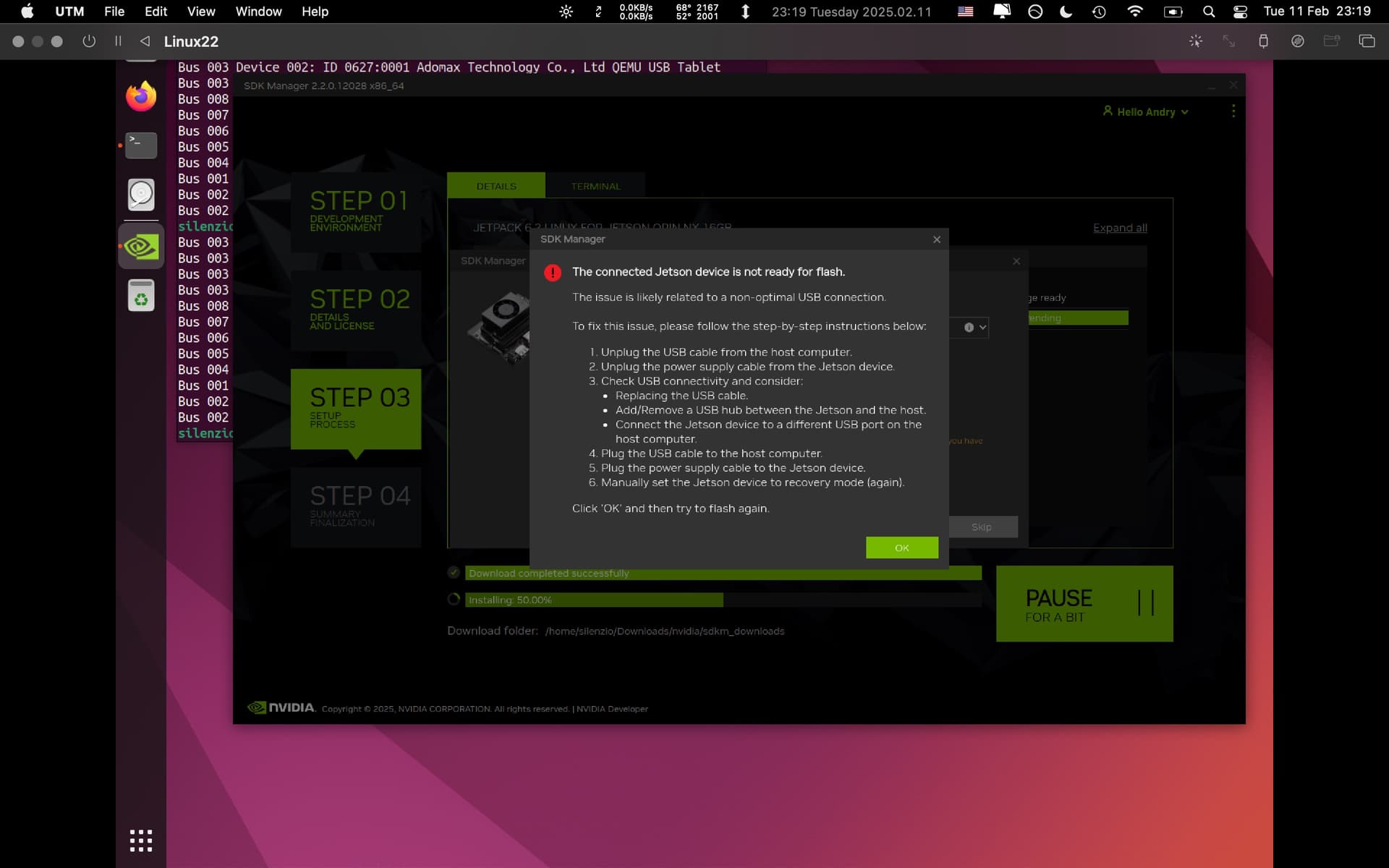

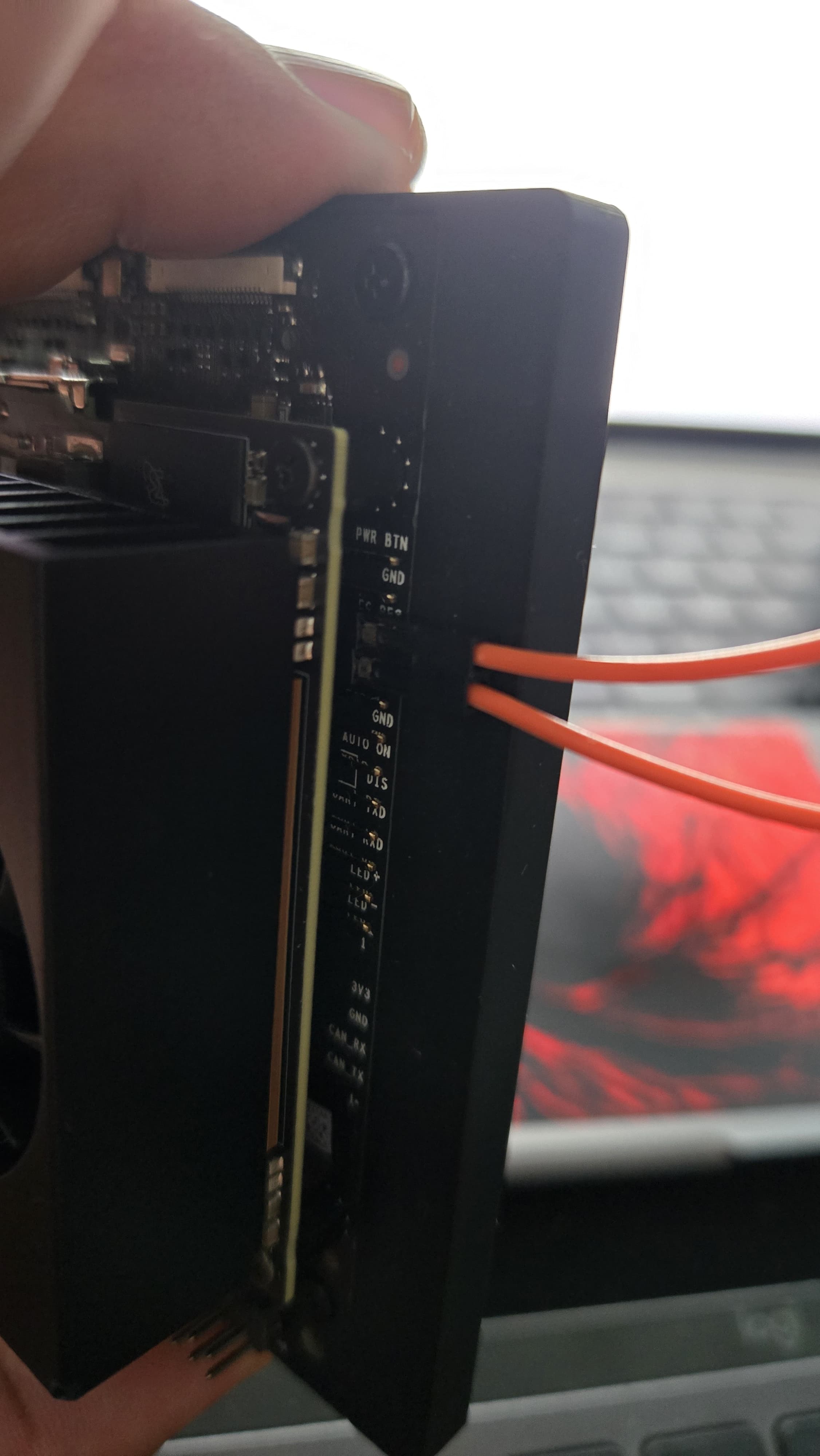

I am flashing my board via SDK manager.
The jumper is installed between pins 9 and 10.
The first steps are going well.
On the third step, the actual flashing, an error appears and this window.
I have changed three USB cables, they are all of good quality, I have tried to insert them into different USB ports. Nothing helps…
The USB speed in the UTM virtual machine was set to 2.0 and 3.0. Nothing helps. The same window with an error appears.
What virtual machine should I use for flashing? I used UTM with Ubuntu 22.
I have a Mac computer (Intel cpu), I do not have access to the Windows PC.
What do you recommend?
Hello
I leave the jumper on during the whole installation.
I use a UGREEN cable and no problems.
I did have to use a “normal” computer with Ubuntu to avoid connection problems.
I use a Mac with ARM and it didn’t let me install the SDK on it.
Than you JorgeLdeJesus for advice!
I ordered a thicker and shorter branded cable. Let’s see if it works…
I’ll try another virtual machine, maybe it will help.

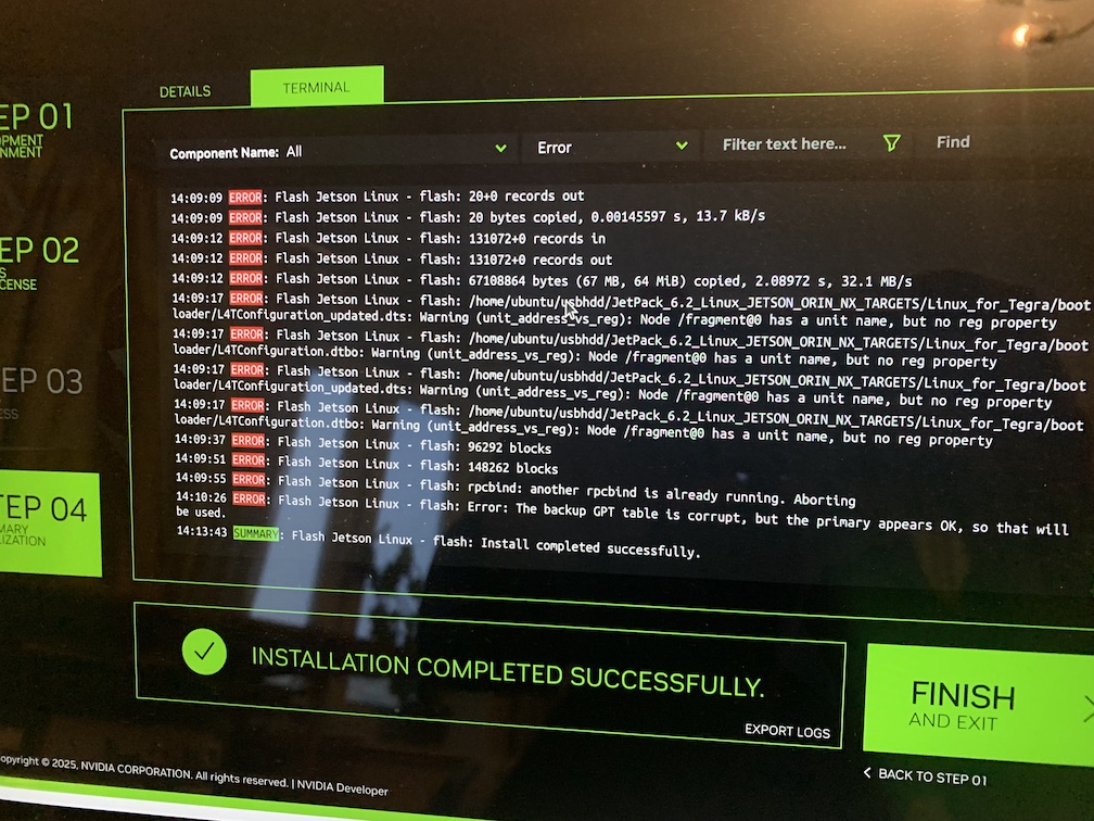

It seem I to have successfully flashed my board using the SDK manager.
I did this just by run a LiveCD with Ubuntu 22 on my Mac, directly without virtual machine. I used the same USB cable, it’s not the cable problem.
The installation complete successful, but in the terminal tab was showing a bunch of errors…
It is this normal? Or something went wrong?

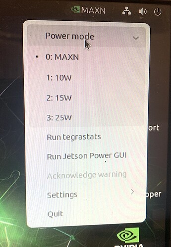

Now it has version 36.4.3-geid-38968081.

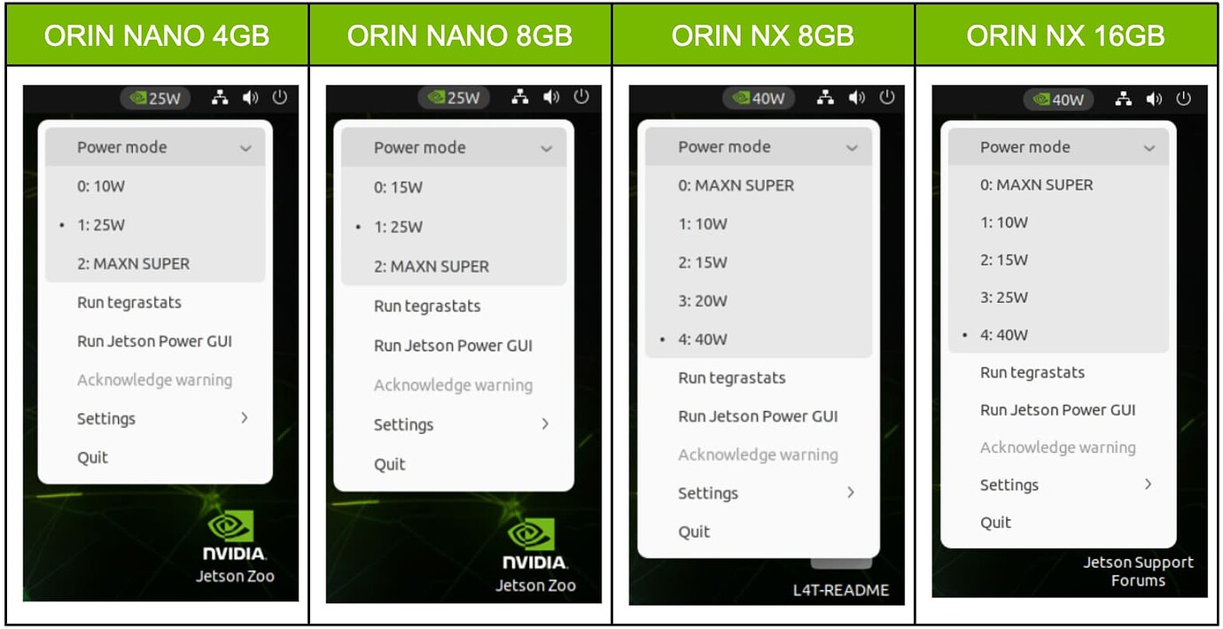

But I don’t see the MAXN SUPER item in the menu on the top left, the old items are still there.
Do I need to do something else to activate the new item?
