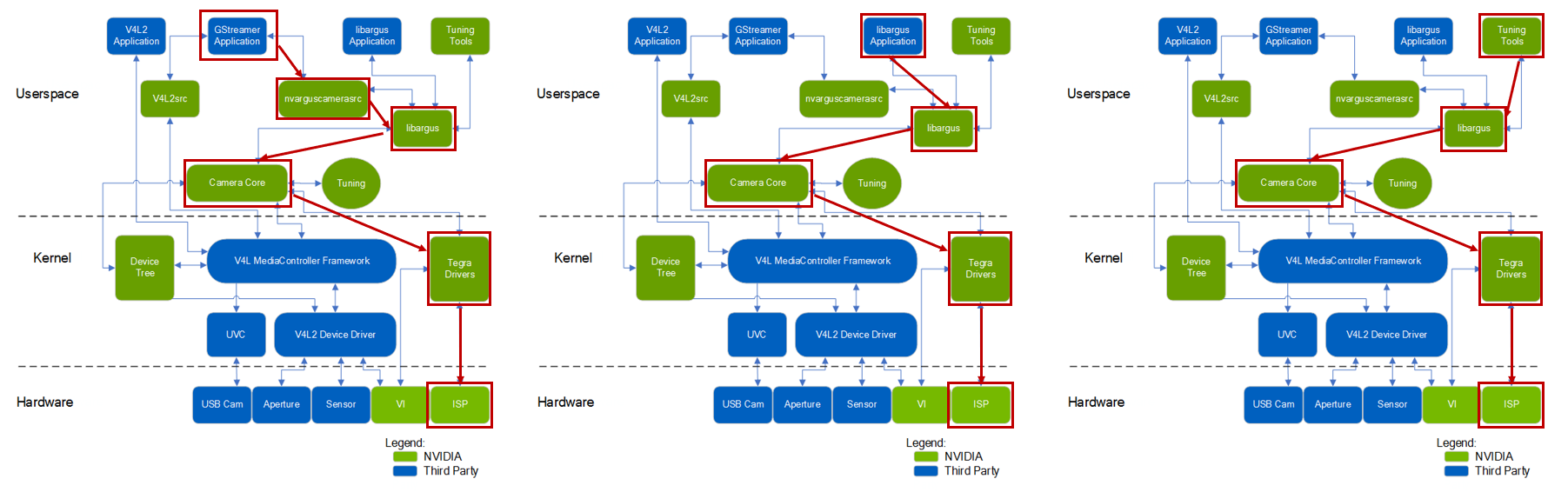

According to the NVIDIA camera software architecture, there are three ways to access the camera ISP
I would like to ask how to approach the ISP through each method. Is there a related command in Linux?

Any of argus relative APP will involve the ISP.
Please check MMAPI and the sample code or nvarguscamerasrc of gstreamer source.
Thank you.
By the way, how do I access using Tuning Tools, the 3rd method?
The tuning tools only public to camera partner.
For tuning you can contact with them.

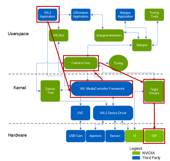

hello, I have one more question.
how can I access ISP the way of use v4l2 Application?
Can’t do it. Only the argus API able access the ISP pipeline.
