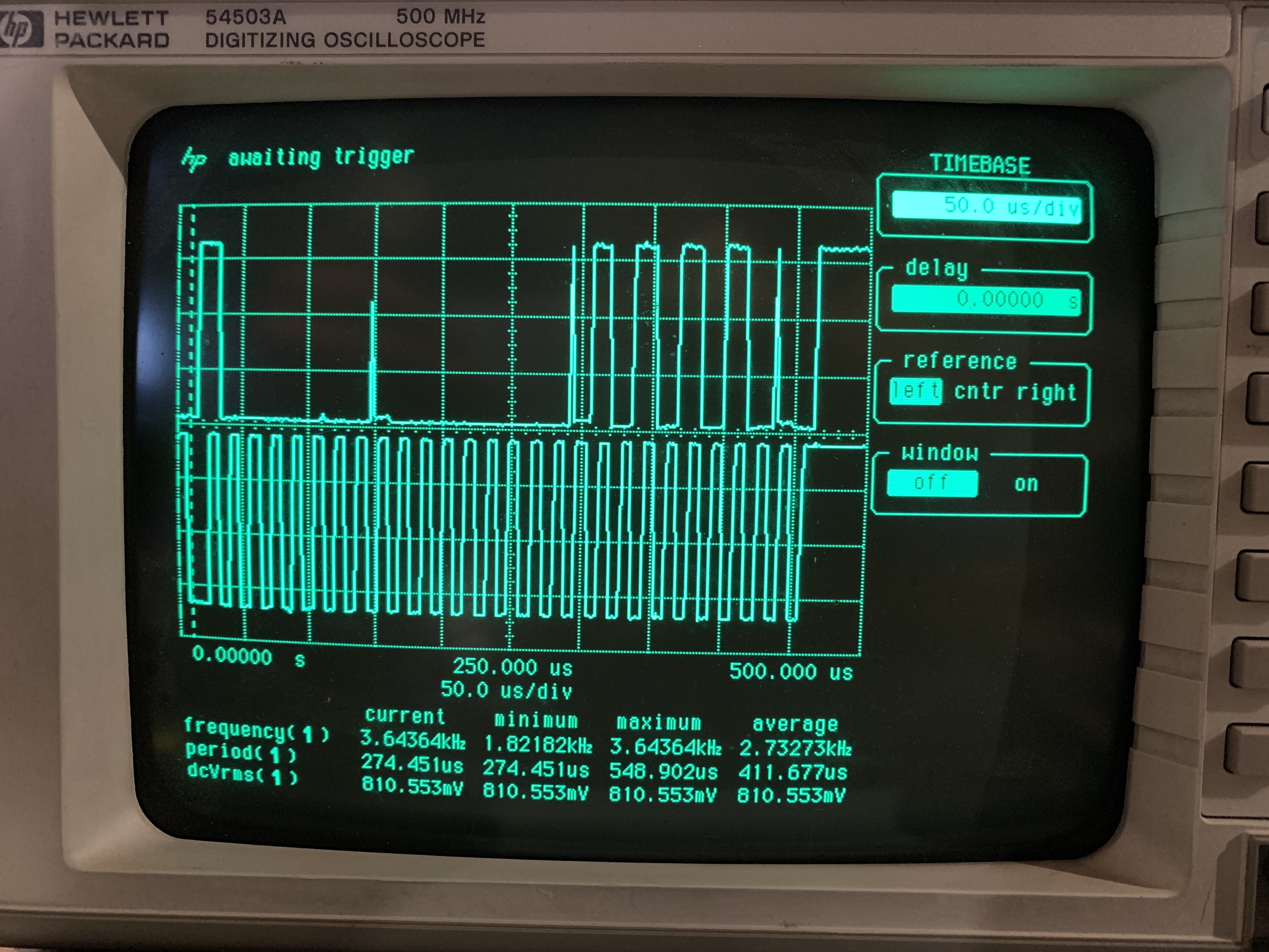

Update and Observations:

Yield the following scope output:
Observations:
  • The clock speed of the Jetson Nano was measured at ~80KHz
  • There seems to be a period where the ground floats just prior to the clock pulses from the Jetson Nano.
  • The Raspberry Pi Zero clock pulses were measured at ~40KHz
  • The clock transitions of the Jetson Nano are not nearly as clean as those of the Raspberry Pi Zero
Questions:
  • Is there a way to adjust the I2C clock frequency of the Jetson Nano, if so, how? Is there documentation on this?
  • Would pull-up resistors improve the waveform? The rising edges seem to recover very slowly.
Any other suggestions are greatly appreciated.
The difference in scope images seems consistent with the ATTiny not seeing the clock/data from the Jetson, and not responding.
The scope from the Jetson has SIGNIFICANTLY weaker pull-ups. You will need to make those pull-ups much stronger; I’d recommend at least 4x more than what you have now. If you’re using the built-in pull-ups on the GPIO ports, then add additional external 4.7 kOhm or less pull-ups to 3.3V for both clock and data. Also try running at a slower clock frequency if 100 (80) kHz doesn’t work.
