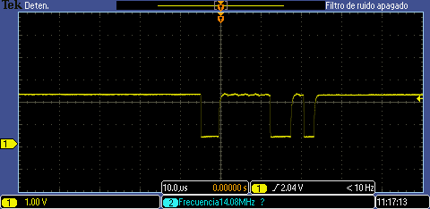

To test the I2C bus 0
Connect the oscilloscope to PIN 27 in J21 TX2 development kit.
run the script python3 i2c_gpio.py -p 0
press key ‘r’
in the oscilloscope I see activity, the read request part of the communications
TEK00000

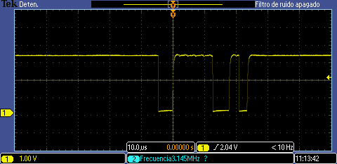

To test the I2C bus 1
Connect the oscilloscope to PIN 3 in J21 TX2 development kit.
run the script python3 i2c_gpio.py -p 1
press key ‘r’
i2c_bus_1
As you can see bus 1 has 2.2 V and not 3.3 V I dont know why this happens, but even the voltage is not 3.3 you can see the request signal

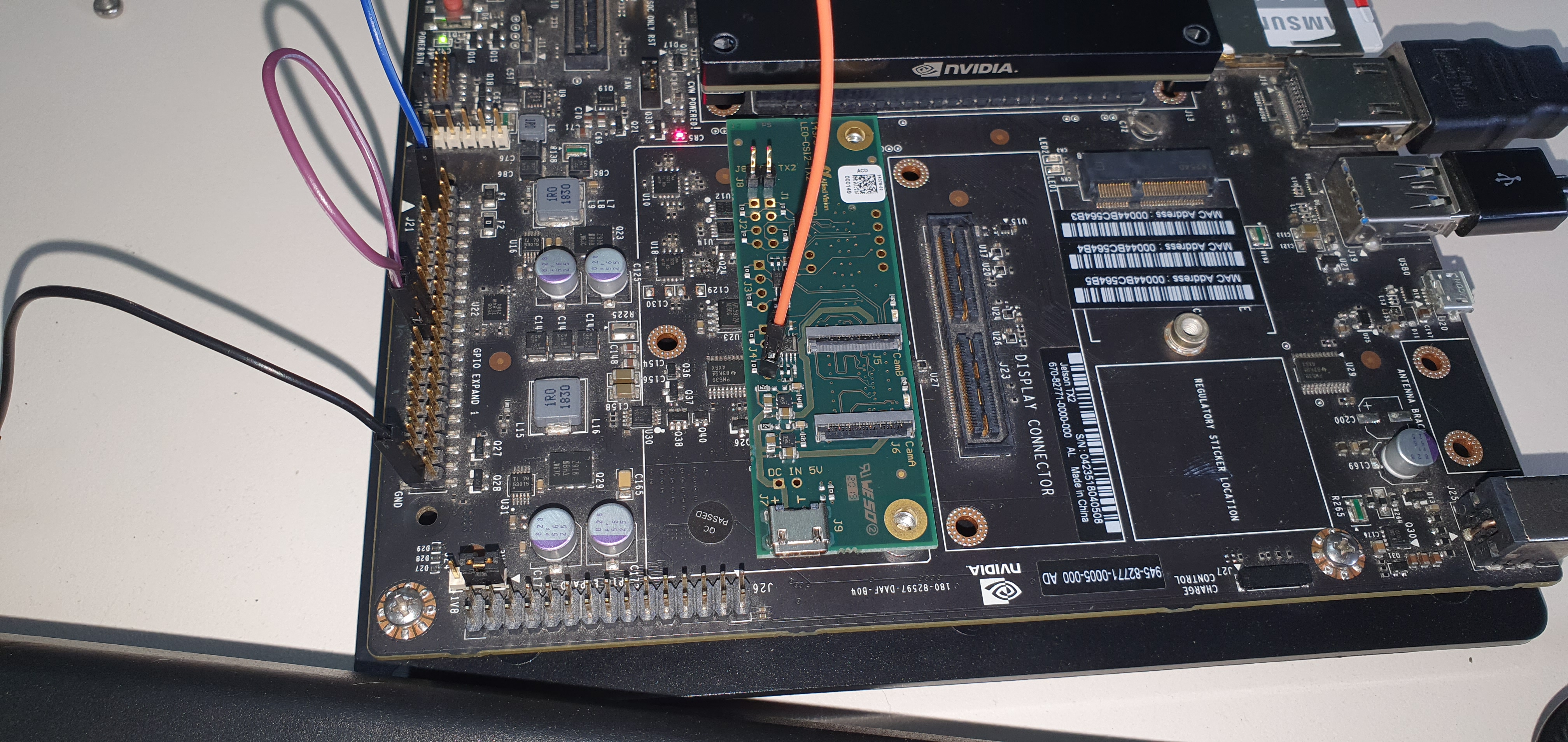

To test the I2C bus 2
The bus 2 is the one that sends the data over the MIPI port.
Connect this piece to the camera port of the TX2 developer kit. As you can see in page 17, the J4 connector PIN4 has I2C data.
using the L4T 32.5.1
run the script python3 i2c_gpio.py -p 2
press key ‘r’
in the oscilloscope does nothing, there is no I2C signal in the I2C bus 2.
using the L4T 32.5
press key ‘r’
I see activity in the oscilloscope.
i2c_bus2
Here is a picture of the setup.

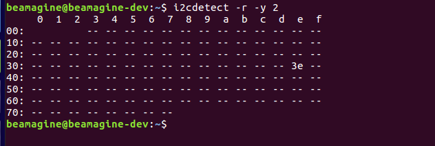

Could you help to clarify the i2cdetect -y 2 on 32.5 and 32.5.1 to check if any different on your device.
@eduardo.bernal
This bus was disable if there’s no any camera connected. You can try to modify the device tree to enable it.
/proc/device-tree/ i2c@3180000 /status
Hello @ShaneCCC
Sorry for answering late.
I have done the i2cdetect test and check the value of /proc/device-tree/ i2c@3180000 /status
This is the result with the 32.5.1
i2c_detect_32.5.1_status
and this is the result with 32.5
i2c_detect_32.5
Does that means working without problem?
@ShaneCCC as you can see in the images, the 32.5 version works, beacuse there is a 3e address detected, but in the 32.5.1 there is nothing, so its not working, aslo the status of the i2c@3180000 is “okay” so if I understand it, it means that you can send data over the bus with the python script
