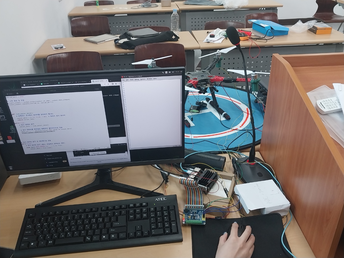

I'd like to receive data from Jaxon Nano in real time
The sensor value is sent to the jetson nano board through a converter, but I want to receive the real-time value sent to the laptop matlab, what should I do?
